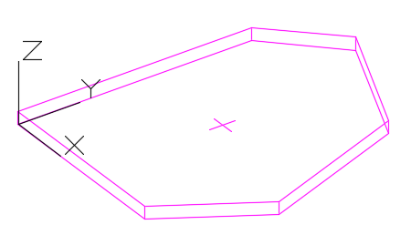

The polygon plates are placed in the X/Y plane of the current coordinate system. The plate thickness direction is in the positive Z direction. You can control the Advance default plate thickness from the Management Tools.
To access the command
Ribbon: Objects > Plates:
Command line: _AstM4CreatePolyPlate
To create a polygon plate using points
