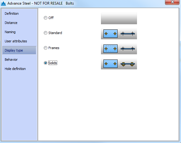

On this tab of the properties dialog box, you can select the bolt display type.
Display type |
Bolts |
Description |

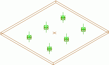

Off |
Only the holes are displayed |
Standard |
Section edges and processing objects |

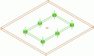

Frames |
The definition frame is displayed |

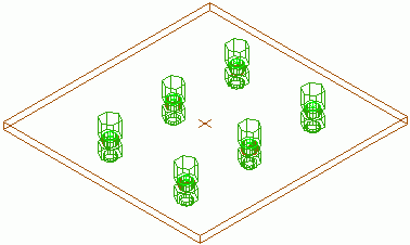

Solids |
The bolt and nut solids are represented |
