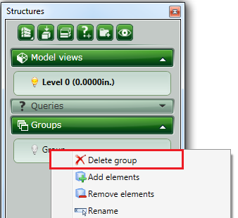

Remove groups
You can remove groups at any time by deleting the group from the Project Explorer. When a group is deleted, it is disconnected from all the objects assigned to it. The contained elements are not deleted.
Groups can only be deleted when:
