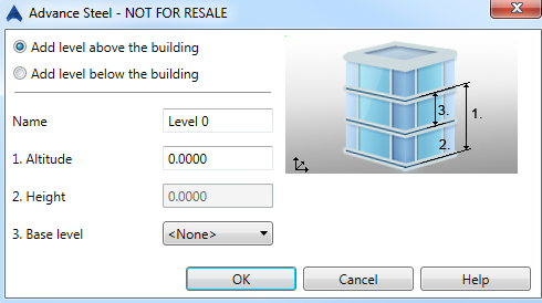

Allows creating a level above or below a building and setting the parameters.
To create a new level:
These buttons are used to select the creation method. Changing the selection, changes the picture and the controls underneath.
Add level above the building
Creates a level above the building.
Add level below the building
Creates a level below the building.
Name
The name of the current level.
Altitude
Defines the altitude of the current level. The altitude is the distance from the level main workplane to the WCS origin.
Negative values are allowed.
Height
Defines the height of the current level. The height is the distance between the level main workplane and the base level workplane.
Is empty and disabled when a base level is not specified.
Base level
Select the level to be used as reference for the current level. The list contains all the levels of the current building, in the same order as in the Project Explorer .
Modifying the base level does not modify the structure objects currently connected to the level.
