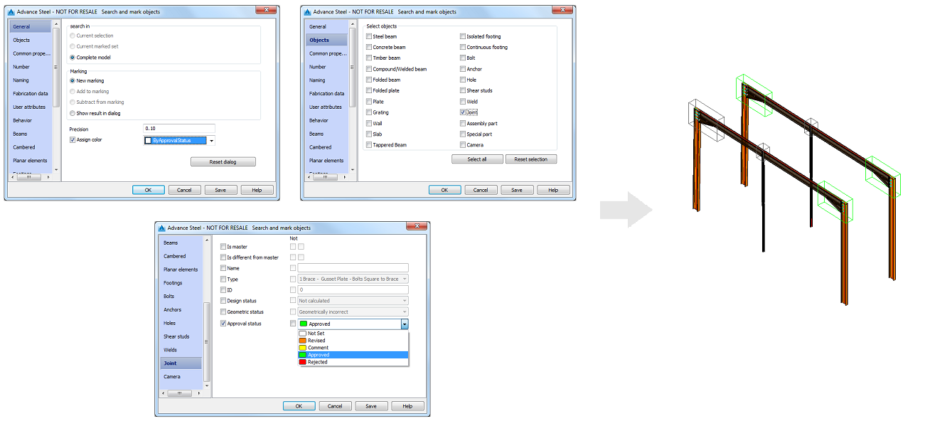

Search and mark joints in the model by Approval Status.
The Search and mark objects dialog has options that allow you to mark joints according to their Approval Status or search by Approval Status.
Each Approval status has a different color assigned to it and after searching for the desired joints, the results will be highlighted in the model with the specific approval status color:
