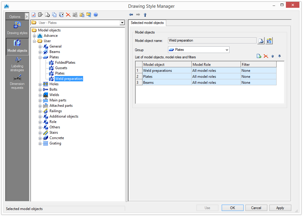

Model Objects Properties
Model objects act as filters for objects from the 3D model. A model object is defined by the Advance object type (e.g. Beam), model role (e.g. Column) and an additional filter (e.g. with holes).
Add / rename model objects
The list of model objects, roles and filters can be modified. New strategies can be added or existing strategies can be renamed.
Button Function
Define a new model object. A copy of the current settings is created. It can be moved to another group using the Group drop-down list. A new item appears in the tree panel under the specified group.
Rename the model object. The current settings are saved under a different name.
Manage the list of model objects
The toolbar contains all the necessary management functions:
Button Function
Add a model object
Delete the selected model object
Move the selected model object up the list
Move the selected model object down the list
