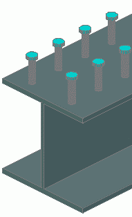

Shear studs can be inserted in the model exactly the same way (Cyan) as bolts, with the same options for displaying and editing. Holes are dependent on their reference object regarding their representation type.
In the center of the stud shear-pattern (= point of intersection of the rectangle's diagonals) a weld point is inserted. It connects the studs with the beam or plate and must not be deleted.

Bolts and shear studs are created in the color cyan (by default) as individual Advance Steel elements and can be modified according to your preferences. Changes in the bolt pattern will also automatically update the holes.
