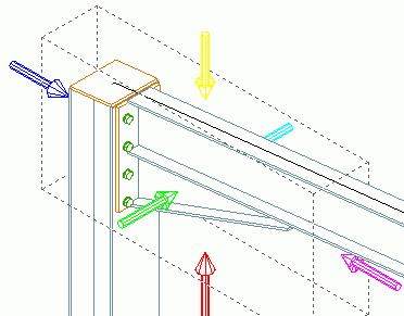

Quick views allows zooming quickly to a selected element, an assembly or a joint and display the objects with a depth limitation.
The area is defined by a view direction and depth limitation. Objects that are longer than the depth setting are displayed clipped.
After the element is selected, the symbols for the view direction are displayed. The arrow points in the Z direction. The view box size is defined by setting the view extensions in the X, Y and Z directions.
The XY plan is displayed.
After creating a quick model view, the entire model can be displayed again using All visible tool.
