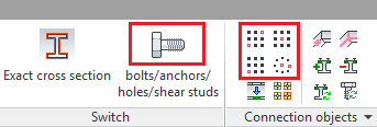

All four connection types, bolt patterns, anchor patterns, hole patterns and shear studs are created with the same commands.

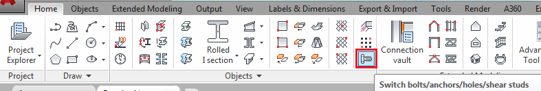

A switch button on the Objects tab allows switching between the object type. The tools for creating bolt hole patterns and shear studs can be found in the Objects tab, Connection objects panel.
For quicker access, the switch is available also on the Home tab.
