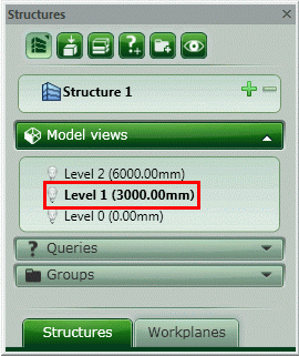

Newly created objects are placed on the active level. You can switch from one level to another by double clicking it. Active levels are displayed in bold on the Structures tab of the Project Explorer .
