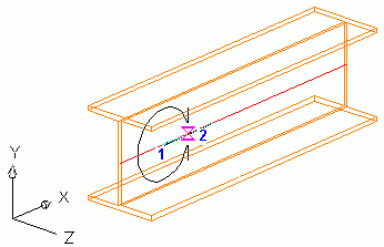

A circular contour is cut from the beam. It can be an outside or inside (hole) contour. The circular contour is defined by entering a center point and a second point defining the circle's radius.
Note:
- The circular contour depends on the position of the coordinate system. The contour is created parallel to the UCS.
- When the beam is manipulated (e.g., with the grips), the contour is still assigned to the selected beam end and it maintains its distance to the end.
- To cut a circular contour from a curved beam it is recommended to insert a coordinate system at a point of the object.
To access the command
Features tool palette:
Command line: _AstM4BeamContourNotchCircle2Dig
To create a circular contour using two points
- Select a suitable UCS.
- Features tool palette: Click
- Select a beam at a reference end.
- Define the contour center point.
- Identify a point to define the circle radius.
- The circular contour is created. The properties dialog box appears.
The radius, gap, width and grid values can be changed.
