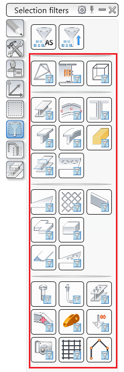

This tools allows you to filter a set of objects of a specific type ( beams, plates, gratings etc) from the entire model or from a selection. The object type from the selection that you want to filter is selected from the Selection filters tool palette.
To access the command
Selection filters tool palette: Select the desired element type
Command line: _AstM4SelectObjectByName [type of object]
To filter an object selection
