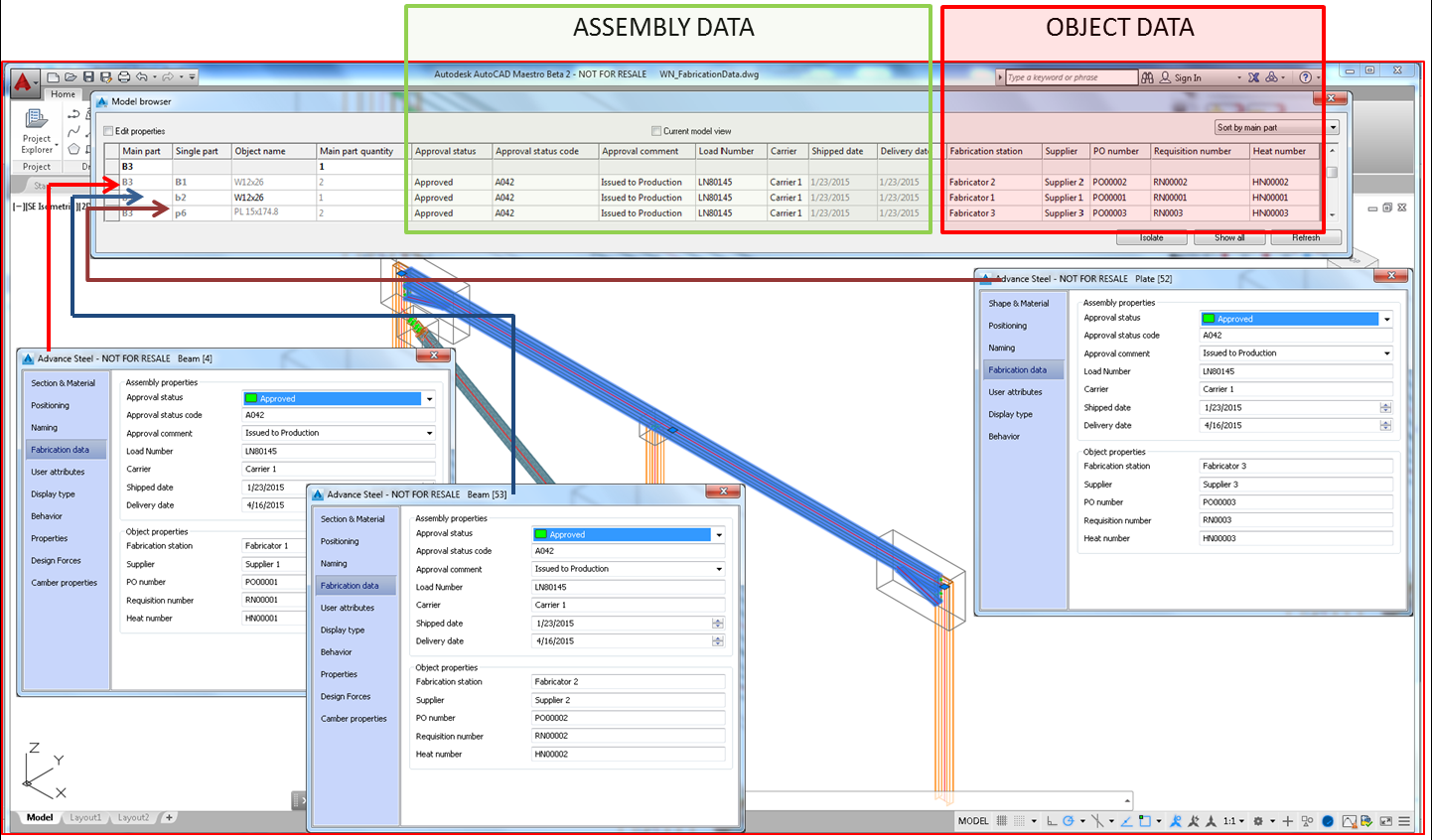

Model Objects (beams, plates, gratings etc.) and Assemblies (groups of elements joined by certain criteria) have different fabrication information available in the model, depending on the project state:

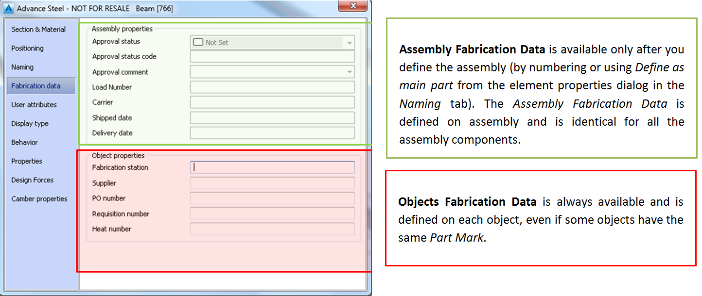

Approval status, Approval status code and Approval comment mark the modeling status of an assembly.
Assembly Fabrication Data:
Element Fabrication Data:
You can access and edit the Fabrication Data from the Model Browser - in the Selection Tool Palette:

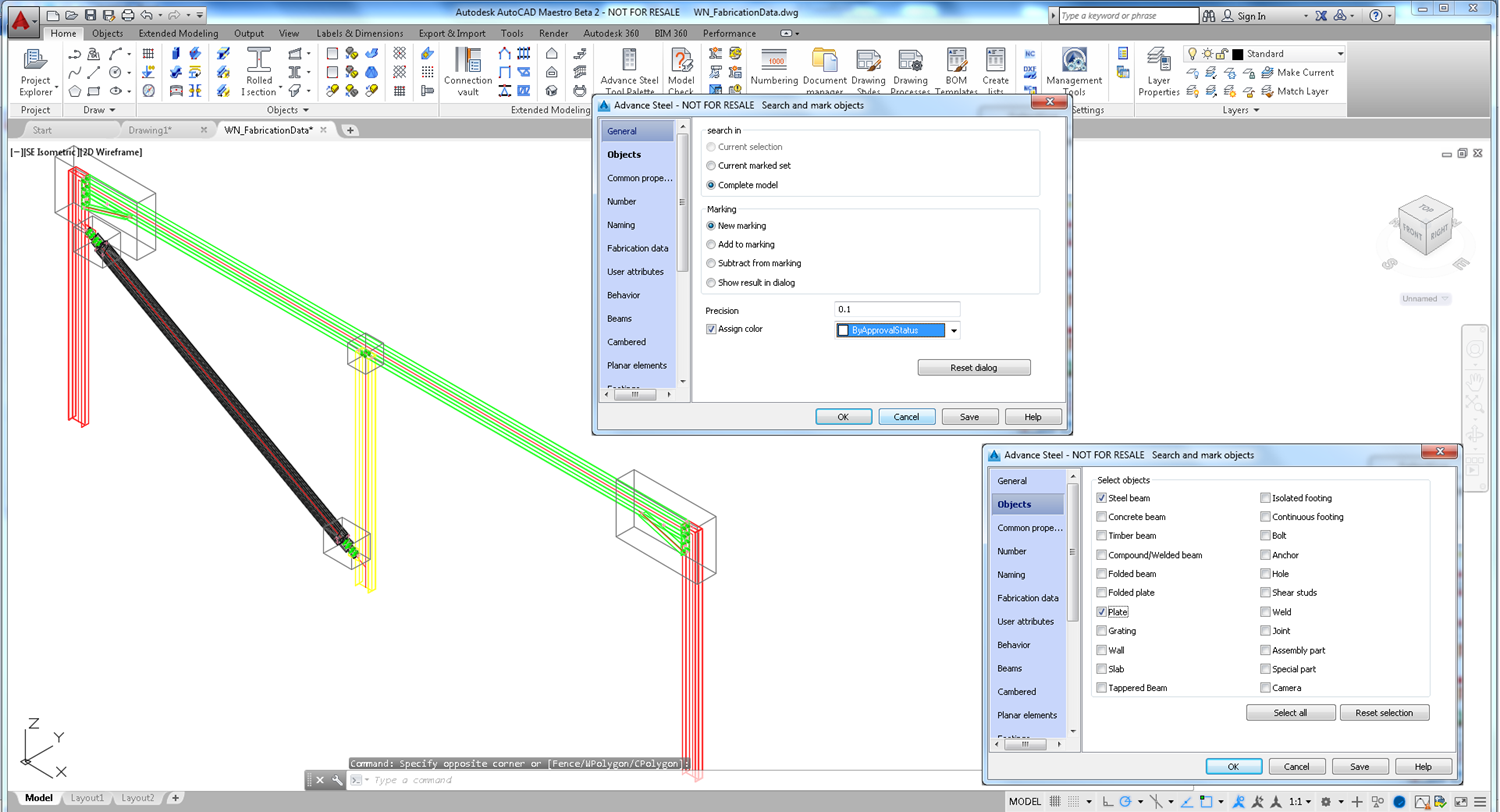

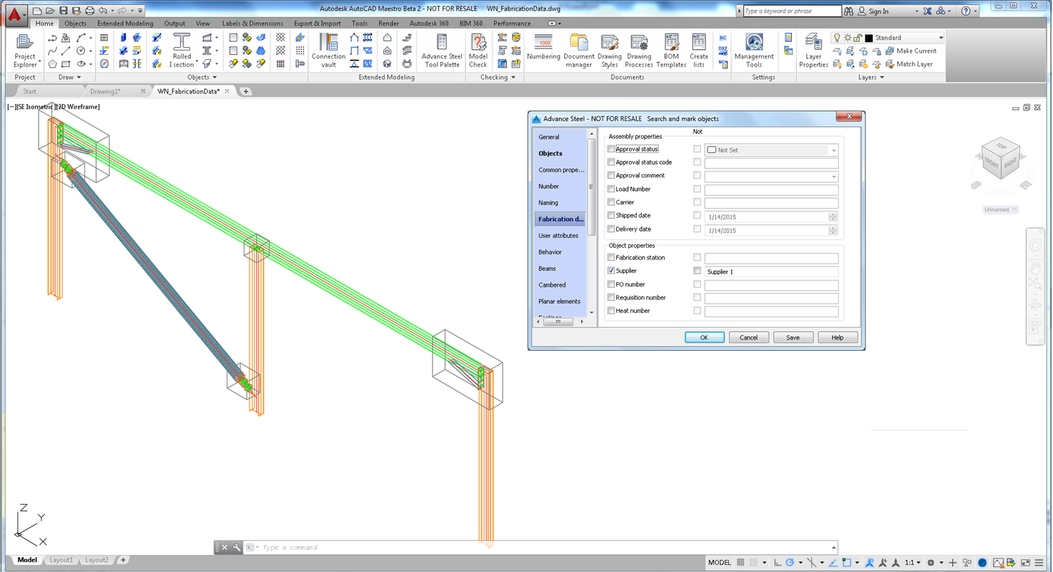

Search and Mark objects have new options that allow you to mark elements according to Approval Status or search by fabrication data information.

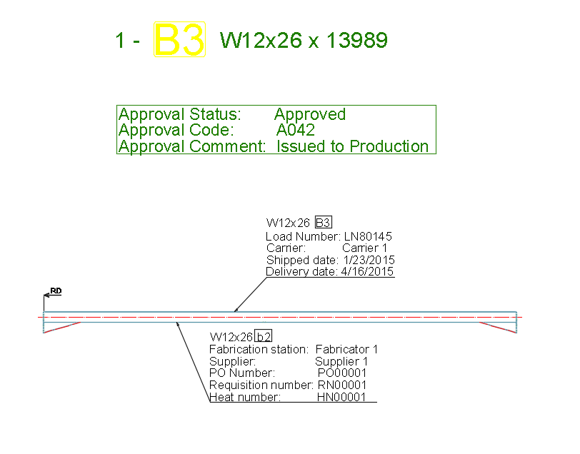

New information is found in drawing tokens, so you can insert them in labels and symbols.
