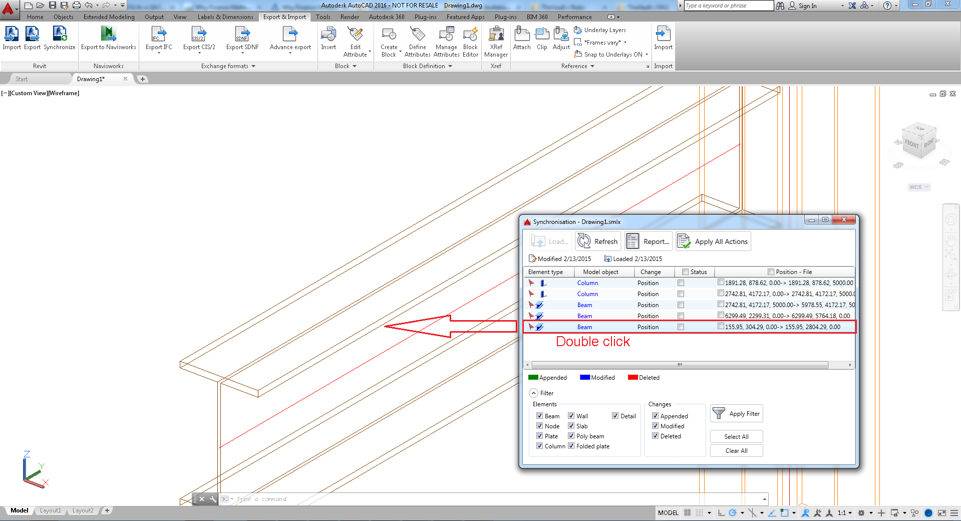

Focus mechanism implemented in Advance Steel
This mechanism helps identify the elements displayed in the Synchronization dialog. If you double-click a line from the Synchronization dialog, Advance Steel will focus on the element in the model.
