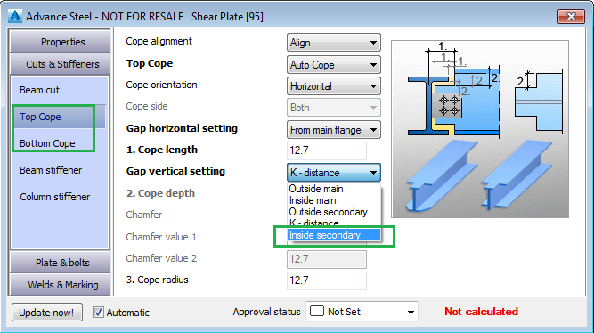

Shear Plate connection – new Inside secondary option for calculation of the cope vertical depth
Besides the existing Inside main, Outside main, Outside secondary options, you can now choose the Inside secondary option, so that the vertical dimension of the cope gap is calculated starting from the inner flange edge of the secondary beam. The new option is available for both top and bottom copes, in the respective tabs from the joint Properties.
