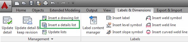

With the new Insert a details list feature you can create a bill of material that contains information about specific details in a drawing, based on your selection. You can find the command on the Ribbon, in the Labels & Dimensions tab > Management panel, placed under the Insert a drawing command:
The workflow for creating a list for specific details is very similar to the one for creating a list for the entire drawing. However, before placing the list in the drawing, you need to select the desired details. All elements from the selected details will be evaluated in the list. The selection can include one or more details, including overviews.
