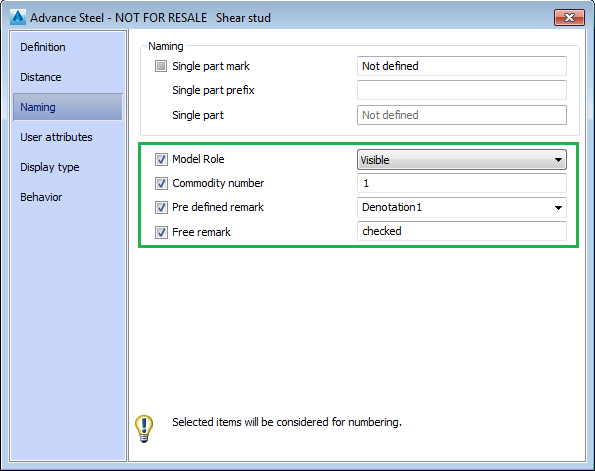

For a multiple selection of shear studs, changes made for the parameters in the Naming tab from properties are applied to all selected shear studs. This applies to the Model Role, Commodity number, Pre-defined remark and Free remark values and for their corresponding check boxes:
