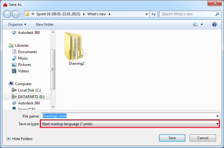

The Export dialog contains the SMLX file format. Exports are only allowed with the new extension.

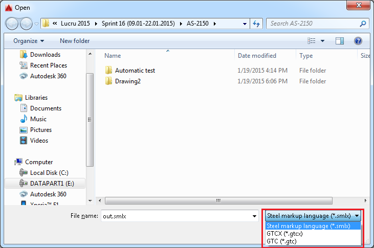

The Import dialog contains the following file formats: SMLX, GTCX and GTC.

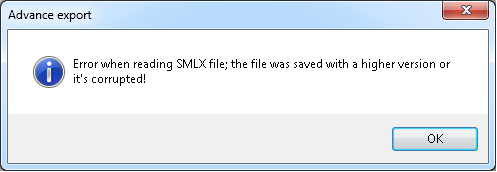

If a newer version of the SMLX file is imported, an error message will appear and the file will not be imported.
