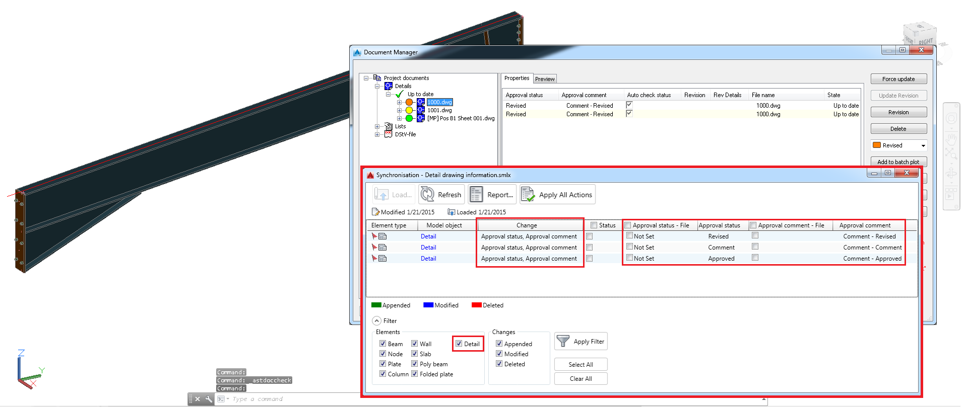

This information can be synchronized. the Synchronization dialog has a new Detail filter and by using it you can display only the details in the dialog
Example:
Create an assembly in a model and generate several drawings:
- Export the model to SMLX.
- Open the Document Manager and change the Approval Status and Approval Comment for the generated drawings.
- Open the Synchronization dialog and load the previously exported SMLX file. All the changes will be displayed in the dialog.
