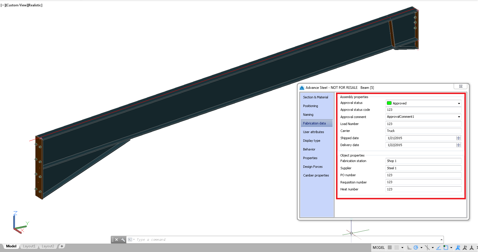

The data is displayed in two categories: Fabrication Data and Element Approval inside the Synchronization dialog.
The Fabrication Data category includes Load Number, Carrier, Shipped Date, Delivery date, Fabrication station, Supplier, PO Number, Requisition number, Heat number.
The Element Approval category includes Approval Status, Approval Status Code, and Approval Comment.

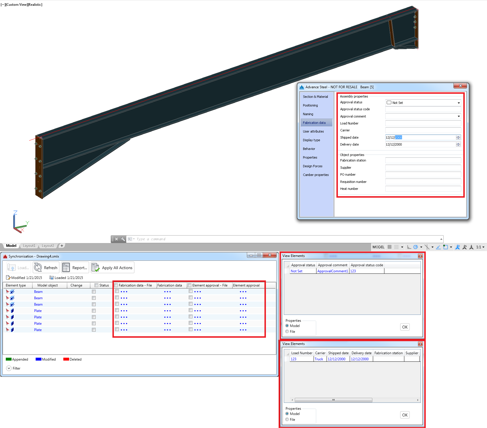

If you double-click on the 3 dots (“…”), under each category, a second dialog will pop-up. This window will display the stored data for each field in both the file and the Model.
