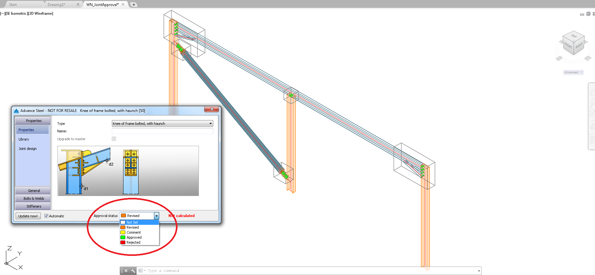

Joint Approval Status

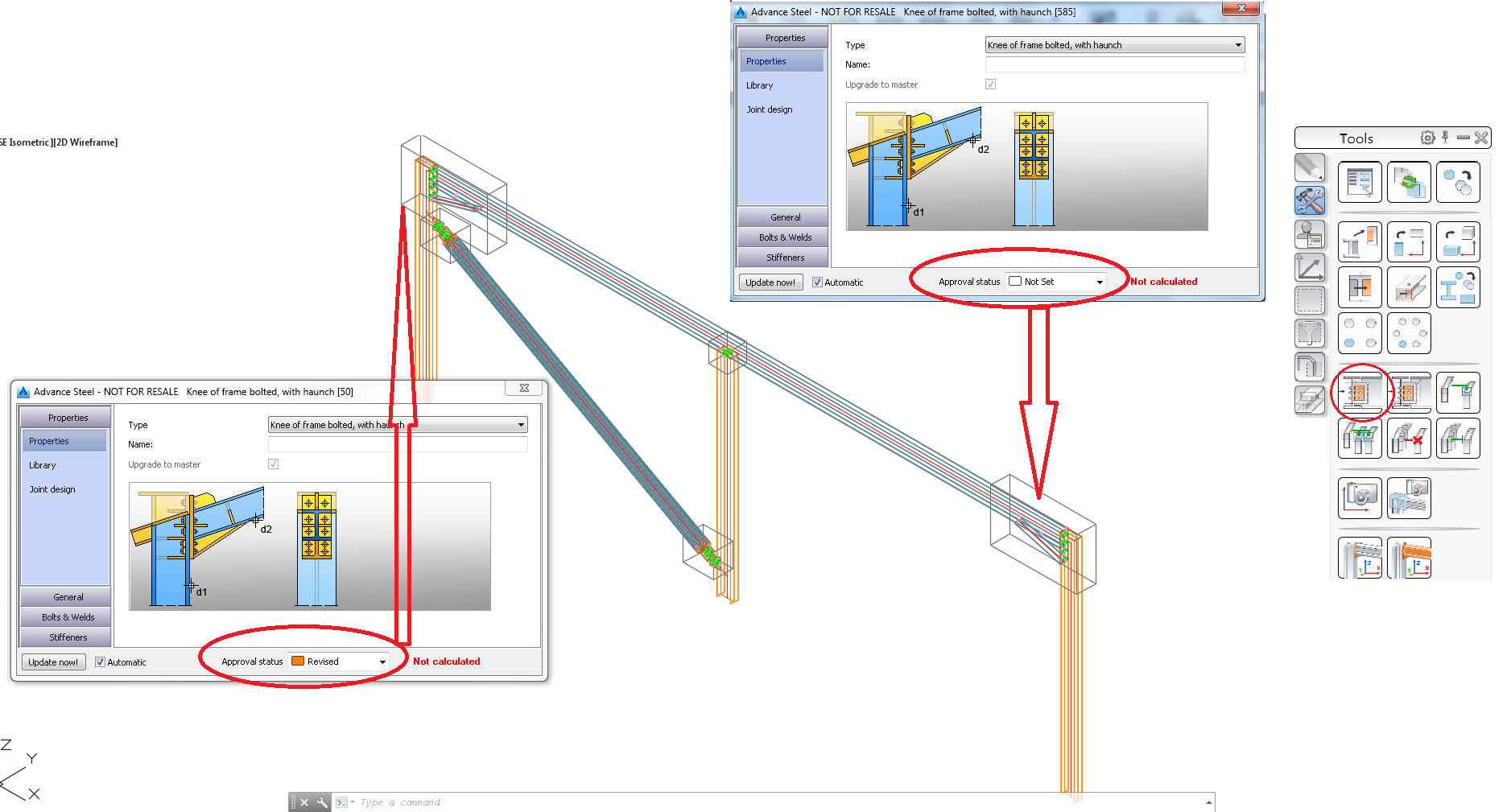

You can now mark the fabrication status of a connection. The fabrication status is different from Design Status (which is a "calculation" status). Each status is assigned a color.

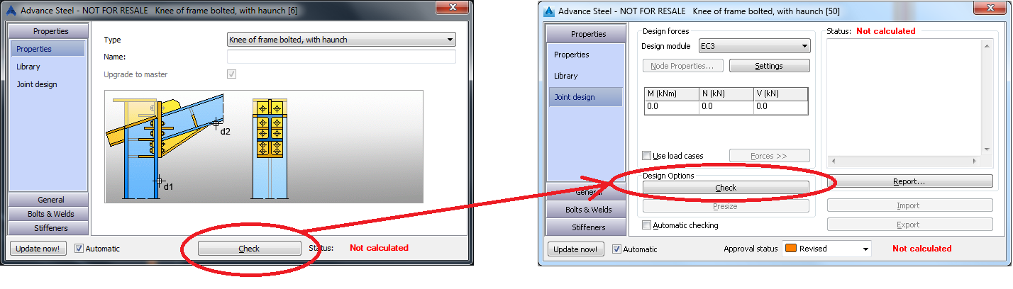

Note: The Joint design Check button was moved to Properties > Joint design tab.

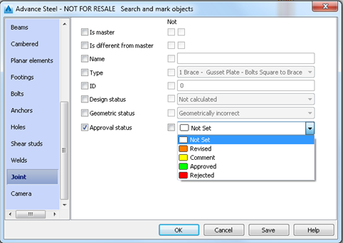

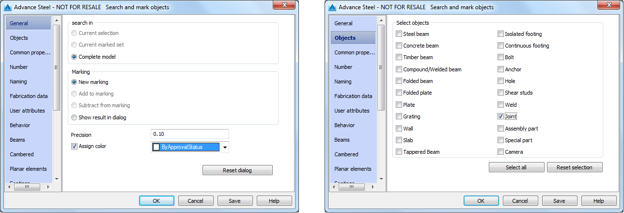

Search and Mark objects have new options that allow you to mark joints according to Approval Status or search by Approval Status.

When you create a new joint using the Create by Template or Create by Template, Multiple commands, the original joint Approval Status is not transferred - it will be Not Set.

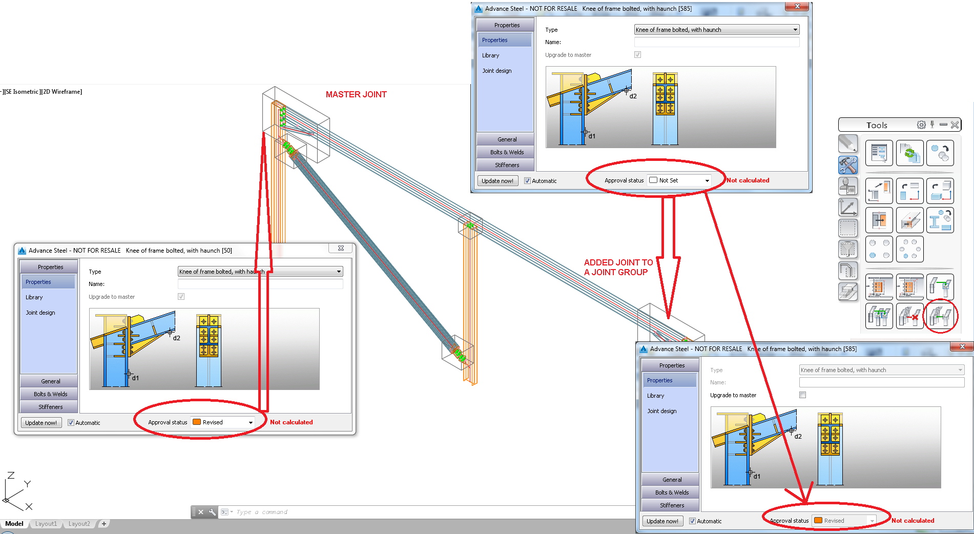

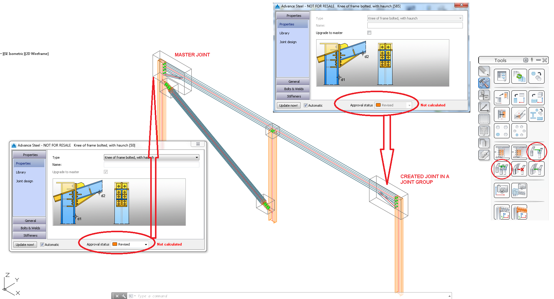

When you create a new joint using the Create Joint in a Joint Group or Create Joint in a Joint Group, Multiple commands, the master joint Approval Status is transferred - the new joint's Approval Status will be the same as the master joint's Approval Status.
When you create a new joint using the Add Joint to a Joint Group command, the master joint Approval Status is transferred - the new joint's Approval Status will be the same as the master joint's Approval Status. When you use the Remove Joint from a Joint Group command, Approval Status doesn't change.
