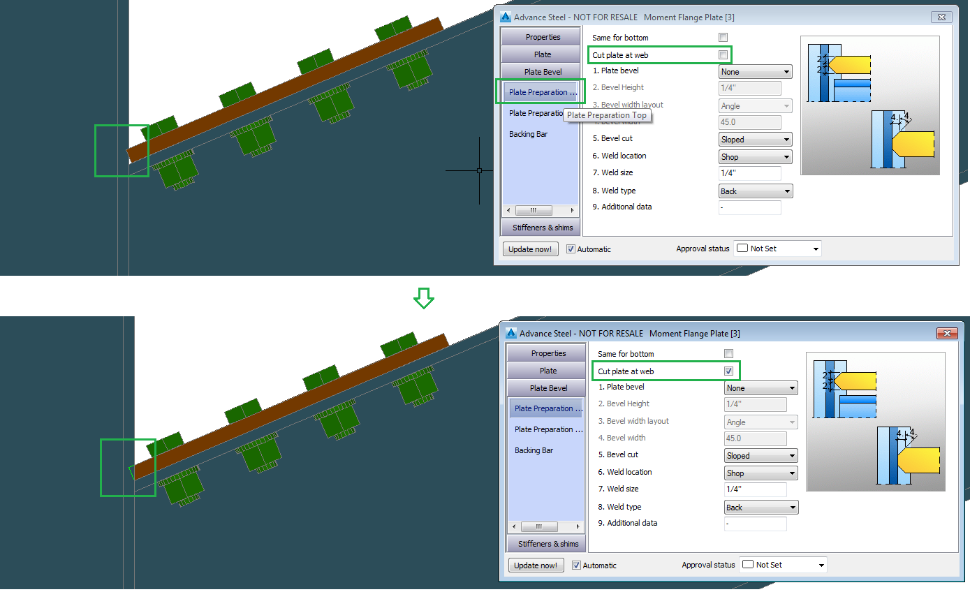

Moment Flange Plate connection – new Cut plate at web option for extending the sloped flange plate to the column’s flange
A checkbox has been added to the Plate Preparation tabs in order to obtain the same behavior for the sloped plates as for the sloped beam. If the Cut plate at web option is used, the plate is extended to "touch" the column, as presented below:
