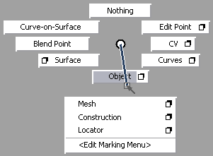

  1. Hold + (Windows) or + (Mac), and press and hold a mouse button.
    The mouse button marking menu appears at the location of the mouse pointer.
  2. Keep the mouse button held down and drag out toward a tool name. A thick black line shows the direction of the mouse pointer.
  3. Release the mouse button to choose the highlighted tool.
