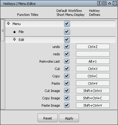

  1. Choose Preferences > Interface > Hotkeys/Menu Editor.
  2. Click in the editable field next to the tool or menu item name.
  3. Type a letter (for a single key hotkey), a function key (for example F4), or a control key string (a combination of the words Alt, Shift, and/or Ctrl followed by a letter) and press (Windows) or (Mac). Do not use F1.
    If you type a single letter, you can only use that hotkey when single key hotkeys are on.
    Tip:
    Hotkeys show up next to the names of menu items in the menus.

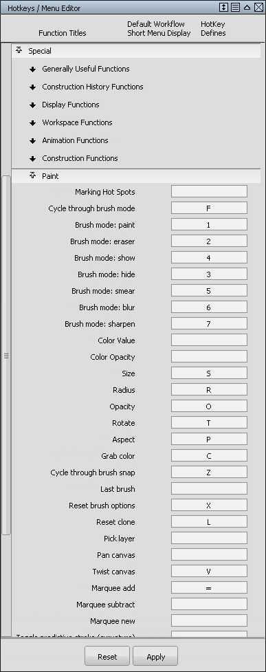

Paint hotkeys are listed in the Special:Paint section, near the bottom of the editor.
All the functions accessible through the menus of the Canvas Layer Editor are listed in the Special:Canvas Layer Editor section.
See Windows > Editors > Canvas Layer Editor.
However, you can map the rest of the function keys. Do not change any of the modify hotkeys. A modify key is a hotkey that involves a mouse click-drag-up in conjunction with pressing a key (for example, modifying the radius, opacity, or size of a brush).
