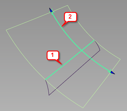

1: input curve; 2: arc of revolution. Axis of revolution is off screen, on the upper right.

  5. Select two points to specify the ends of the arc of revolution. A third point located on the first curve is used to define the arc.
    • The arc is drawn as a green line with arrow manipulators on both ends. If you do not see the arc, change the axis of revolution in the control window. The axis cannot be in the same plane as the arc of revolution.
    • The Helix surface is built.
    • The axis of revolution is drawn in blue.

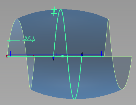

    • Adjust the Pitch to create a spiral-shaped surface.
      Pitch of 200.0
    • Use the arrow manipulators on the arc of revolution (or the Start/End angle sliders) to modify the angle of revolution. You can move the arrows, or use the angle sliders to create a revolution of more than 360 degrees. This technique, along with the Pitch, is useful for creating screw-shaped surfaces.
