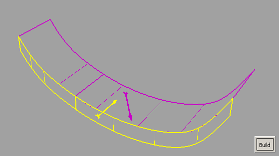

    An arrow appears for each set of surfaces, indicating on which side of the surfaces the fillet will be built. The software makes an educated guess about where you intend to build the fillet, and orients the arrows accordingly.
  5. Click on an arrow to flip its direction, or click on a surface to make the indicator appear at that location.
  6. Click Build.
    The fillet is built on the side of the surfaces indicated by the arrows.

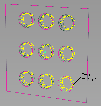

Create fillet surfaces using multiple input surfaces
  1. Choose Surfaces > Multi-Surface Fillet > Surface Fillet .
  2. Adjust settings in the Surface Fillet Control window.
  3. Select the slab surface and then select all the input surfaces. (Either box pick with the initial position on one of the slab surfaces and then select all of the surfaces, or select one element of the slab surface set, and then using the middle mouse button, box select additional surfaces until all are selected.)
  4. Click Build.
  5. To rework the results, use Query Edit.

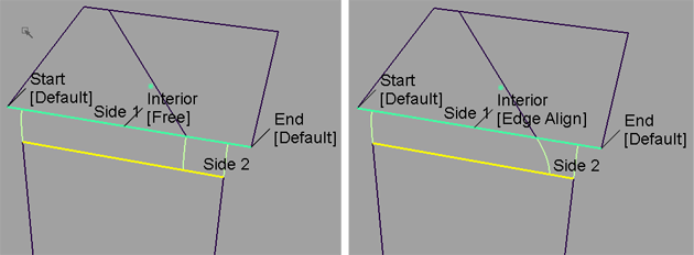

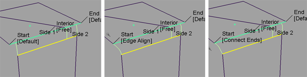

Adjust the alignment of the edges of the fillet/blend surfaces
Use the options in the Flow Control section, or click the labels on the model, to control how the blend surface(s) edges (in the V direction) meet up with the edges of the boundary surfaces. You can adjust the alignment of the start, end, and (if more than one blend surface) interior edges.
See Surfaces > Multi-Surface Blend > Freeform Blend ) for an explanation of the possible values.
Possible flow control values for Start of blend
Possible flow control values for Interior of blend
