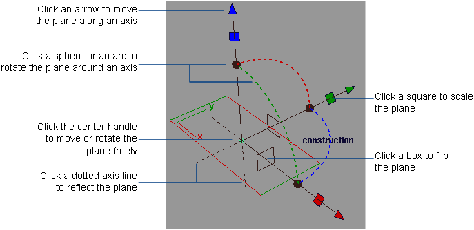

How to use the plane manipulator
Click a handle to select it (the handle becomes white), then either:
Interactive manipulation
  • Drag an arrow handle to move the plane along an axis.
  • Drag a dotted arc to rotate the plane around the axis with the same color (the axis perpendicular to the arc).
  • Drag a square handle to scale the plane along the axis that has the same color as the square.
  • Drag the center handle to move the plane freely.
  • Click one of the rectangular boxes to flip the plane to one of the two perpendicular orientations.
  • Click a dotted axis line to reflect the plane across the X, Y, or Z axes.

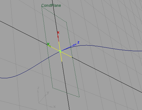

Snap to the intersection of a curve and a plane
You can easily snap to a curve that intersects a construction plane, and position the snap point either anywhere along the curve, or precisely at the point where the curve and plane intersect.
If True Intersections is checked in Curve Snap Options, and you drag the snap point close to the construction plane, a yellow cross appears on the plane indicating that the snap point is precisely at the intersection point.
