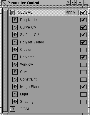

Global parameters
If you click the arrow beside Global, a list of all items that can be animated is displayed. This includes DAG nodes, curve CVs, surface CVs, cameras, lights, and shaders. If you click the arrow beside an animatable item, a list of all the attributes that can be animated for that type of item is displayed.

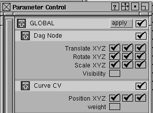

When you expand the DAG node Global parameter settings, this is what you find. Any box with a check represents an animatable parameter. Visibility doesn’t have a check; therefore, this parameter cannot be animated with set keyframe at this time.
When you expand the Curve CV Global parameter settings, you will see that Position XYZ can be animated and Weight, for the moment, cannot.

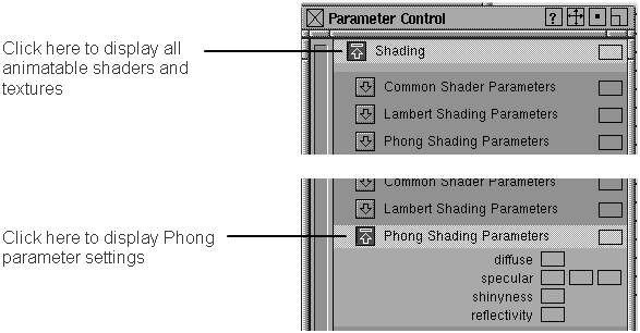

Shading parameters Global settings
When you click the arrow beside the Shading parameters, sub-headings for shader and texture parameters are displayed. Clicking an arrow beside a sub-heading displays the parameter settings for that shader or texture.
Note:
The above illustrations show only a partial list of the shader and texture choices available.For details on shader and texture parameters, see Render > Multi-lister > List All.

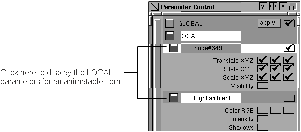

If you click the arrow beside Local, you can see a list of all animatable items that are currently active. If you pick or unpick objects in the modeling windows or select a new shader, texture, or light in the Multi-lister window, the items under Local change to reflect this new set of active items.
Tip:
Check in the Local window before using an animation function that acts on active objects. An example of such a function is Animation > Keyframe > Set Keyframe or Delete > Animation > Delete Channels  .
If you click the arrow beside an animatable item, you see all the attributes that can be animated for that type of item. Usually this list is the same as in the Global parameters for that type of item. However, in some cases, the Local animation parameters are a subset of the Global animation parameters. For example, all lights have color, intensity, and shadow attributes. However, only ambient lights have the Ambient shade attribute.

The Local parameter window lists all items that are active.
Each animation parameter (Global or Local) has a box next to it, which contains a check mark (4) if the parameter is turned ON. To toggle it OFF, click in the box.

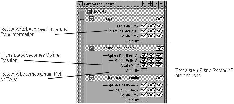

Parameter names for IK handles
Although IK handles are DAG nodes, some types will display parameter names which are different from Translate, Rotate, and Scale, which are the standard for DAG nodes. The following diagram illustrates the difference between spline handles and a single-chain IK handle.

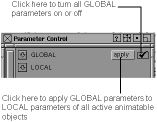

Since an object could have hundreds of CVs, it would be very cumbersome to pick all the CVs, and turn off the Z position Local animation parameter for each CV. Instead, you can pick all the CVs, click the Z Position Global parameter box off in the Curve CV or Surface CV parameter window (depending on whether the CVs are on a curve or a surface), and then click the apply button in the Global parameters section of the window. This applies the Global parameter settings for each type of item to the Local parameter control of each item in the Local parameters window.
Now if you open one of the CVs in the Local parameters window, you see that its Z Position parameter has been turned off.
Next to the Apply button there is a check box. If you click in this box, you can turn all the Global parameters on or off for every type of animatable item at once (a check mark indicates that they are on).
