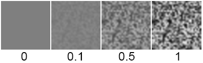

A scaling factor applied to all values in the texture about the texture’s average value. The valid range is 0 to infinity. The slider range is 0 to 1. The default value is 1.

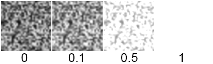

An offset factor applied to all values in the texture. The valid range is 0 to infinity. The slider range is 0 to 1. The default value is 0.
