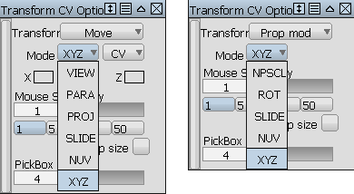

Mode – Left Menu
The left mode menu appears only if Transform is set to Move or Prop mod.
The left mode menu controls the action and the right mode menu controls the objects (CVs or Hulls) that the action affects.
XYZ – This mode moves CVs along the X, Y, Z world axes. The mouse buttons operate the same as in the Transform > Move (or Transform > Modify > Proportional mod) tool.
SLIDE – This mode moves CVs along their respective hull. For Prop mod, the arrows only appear around the primary CV.
NUV – This mode moves CVs along the normal, or in the U or V direction on a surface, using the left, middle and right mouse buttons respectively.
The following three modes apply only to Move transformations.
PROJ – This mode moves CVs in the direction of a hull line, a vector, or constrains the movement to a reference plane.
PARA – This mode moves CVs parallel to a vector or hull line without snapping to it.
VIEW – This mode moves CVs in the plane of the current view.
  • = Unconstrained movement in the current plane defined by the direction of the view.
  • = Movement constrained to the horizontal axis of the screen.
  • = Movement constrained to the vertical axis of the screen.
The following two modes apply only to Prop mod transformations.
ROT – This mode rotates CVs relative to their proximity to a center "master" CV.
NPSCL – This mode non-proportionally scales CVs relative to their proximity to a center "master" CV.
