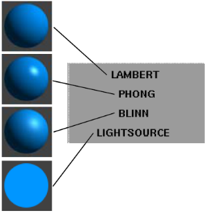

Shading model
Defines the basic surface type (for example, matte, reflective). The default setting is LAMBERT. Each Shading Model has its own set of Shading Parameters.
LAMBERT A matte surface (chalk, matte paint, or unpolished surface)
PHONG A glassy or glossy surface (ABS or SAN copolymer which is often used for car mouldings, telephones, and bathroom fittings)
BLINN A metallic surface (brass, aluminum)
LIGHTSOURCE A special effect. Light falling on the surface is summed and averaged, and no complex shading is done. The surface does not act as a light (that is, it does not illuminate other objects).

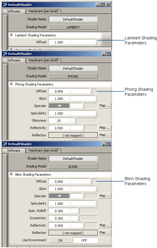

TThe Shading Parameters differ between LAMBERT, BLINN, or PHONG. here are no Shading Parameters when Shading Model is LIGHTSOURCE.

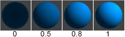

Diffuse
The ability of the surface to reflect light in all directions. The Diffuse value acts like a scaling factor applied to the Color setting: the higher the Diffuse value, the closer the actual surface color is to the Color setting. The valid range is 0 to infinity. The slider range is 0 (no light is reflected in all directions) to 1. The default color Value is 0.8.

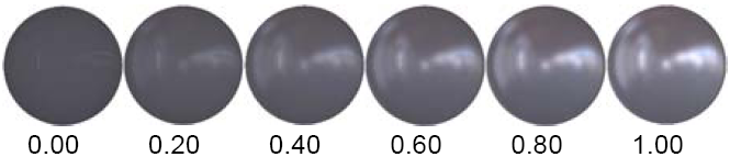

Gloss
Gloss reproduces the effect of surface shinyness. A high Gloss material has specular highlights the same color as its reflections. A low Gloss material has specular highlights the same color as its diffuse shading. Values in the middle blend between these.
Reflective materials with a low Gloss appearance could previously be achieved only with a layered shader.
Specular
The color of shiny highlights on the surface. A black Specular produces no surface highlights. The default color Value is 0.5.
Tip:
For glossy plastic surfaces, use a whitish Specular color. For metallic surfaces, use a Specular color similar to the surface color.

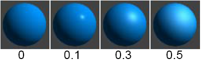

Specularity
Specularity works with Gloss to determine the appearance of specular highlights that are based on the color of the bright parts of the environment cast on the object.
Specular reflections (the blurry ones which in the past only reflected the light sources (point, directional, and so on) used to be colored only by Specular Color. Now they are colored by a blend of the Specular Color and the (diffuse) Color (which is actually the diffuse color of the surface), with the blending being controlled by Gloss. When Gloss is 1.0, it's pure “Specular Color”, when Gloss is 0.0 it's pure (diffuse) “Color.”
This is handy because it lets you do with one shader something that used to require a layered shader. It's also positively irreplacable with image based lighting (IBL), since even a layered shader wouldn't give you independent control over reflected and specular part of IBL.
Experiment with these two parameters together in Hardware shading to get new effects.
Low gloss and high specularity can produce a satiny, lustrous surface like a pearl or wood with an oiled or waxed finish. High gloss and low specularity gives small precise highlights, like highly polished enamel surfaces or wood with a varathane finish.

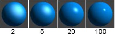

Shinyness
Controls the size of shiny highlights on the surface. This parameter is only available when Shading Model is PHONG. The valid range is 2 to infinity. The slider range is 2 (broad highlight, not very shiny surface) to 100 (small highlight, very shiny surface). The default value is 20.

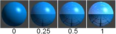

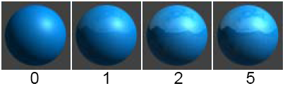

Reflectivity
The ability of the surface to reflect its surroundings (the environment, other surfaces), or the Reflection map, if any. Reflectivity values for common surface materials are: car paint (0.4), glass (0.7), mirror (1), chrome (1). To help visualize the effect of Reflectivity in the shader swatch, temporarily assign a Reflection map to the shader.
The valid range is 0 to infinity. The slider range is 0 (no reflections) to 1 (clear reflections). The default value is 0.5.
Note:
Reflections are calculated only during raytracing.
Reflection
Maps a texture onto the surface to simulate reflections. By default, reflection mapping only works during raycasting. To use reflection maps during raytracing, set the shader’s Use Refl. Map parameter ON.
Tip:
Map only environment textures to this parameter. Mapping a surface texture or solid texture to this parameter does not produce realistic-looking reflections.
Use Environment
Causes the surface to reflect the environment texture assigned to the environment, or the Image Based Lighting tone map. When IBL is on, this option controls diffuse and specular as well as reflected illumination from the Environment. The default setting is OFF.
Use Environment has no effect if an environment texture is not assigned to the environment. If Use Environment is ON, any Reflection map assigned to the surface is ignored.
Use Environment has a different effect during raycasting and raytracing. During raycasting, the surface reflects the environment texture assigned to the environment. During raytracing, the surface reflects only the environment texture assigned to the environment. Any surrounding objects that would normally be reflected by the surface during raytracing will not be reflected when Use Environment is ON. If Use Environment is OFF during raytracing, the surface will reflect the environment and surrounding objects.

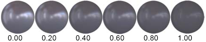

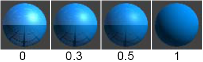

Spec. Rolloff (Specular Rolloff)
The ability of the surface to reflect its surroundings (the environment, other surfaces), or the Reflection map, if any, when viewed at oblique angles. This parameter appears only when Shading Model is BLINN. To help visualize the effect of Spec. Rolloff in the shader swatch, temporarily assign a Reflection map to the shader.
The slider range is 0 to 1. The default value is 0.3.
Tip:
Use a Spec. Rolloff value of 0.7 to simulate a wet surface (for example, wet paint).

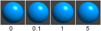

Eccentricity
Controls the size of shiny highlights on the surface. This parameter is only available when Shading Model is BLINN. The valid range is 0 (no highlight) to 0.999 (broad highlight, not very shiny surface). A value of 0.1 produces a small highlight (very shiny surface). The default value is 0.3.

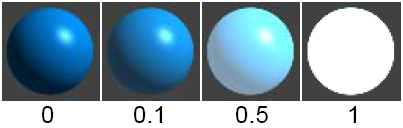

Incandescence
The color and brightness of light that a surface appears to be emitting. (Incandescent objects do not illuminate other objects.) For example, to simulate lava, use a bright red Incandescence. The default color Value is 0 (black).

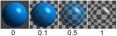

Transparency
The color and level of transparency of a surface. For example, if the Transparency Value is 0 (black), the surface is totally opaque; if the Transparency value is 1 (white), the surface is totally transparent. To make an object transparent, set the Transparency color to a shade of gray or to the same color as the shader Color. The default value is 0 (black).
If you change Transparency from the default black (0), the background of the shader’s Multi-lister swatch becomes a checkered pattern. This is a visual aid and is not rendered in your scene.

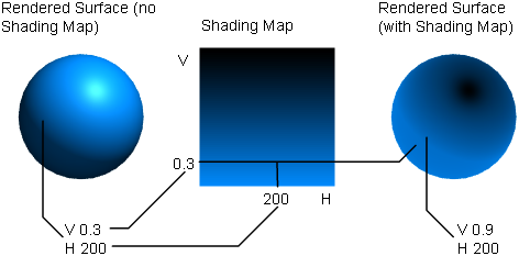

Shading Map
Applies a color map to the surface after it is rendered. The U value of the Shading Map texture is mapped to the surface’s hue, and the V value is mapped to the surface’s intensity (the value defined by [R+G+B]/3). A shading map changes the shader’s color, specular color, and eccentricity, effectively creating a new type of shading model.
A Shading Map is useful for creating non-photorealistic effects (for example, cartoon shading) or for highlighting threshold values (for example, using a ramp texture).

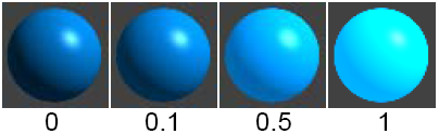

Translucence
The surface’s ability to transmit and diffuse light. Light falling on a translucent surface is first absorbed beneath the surface, and then diffused in all directions. The slider range is 0 to 1. The default value is 0.
The Translucence value of a surface lit by a non-shadow-casting light is effectively zero or infinite (all non-zero values).
If your scene combines a translucent surface with a shadow casting spotlight, faint grid-like artifacts may become visible. If this happens, increase the spotlight shadow Edge quality or lower the shadow Resolution.
For high values of Translucence, lower Diffuse accordingly to avoid washout.
A surface’s actual translucence is based on the illumination it receives from lights, and is not related to its transparency. However, as an object becomes more transparent, its translucent (and diffuse) illumination gets dimmer.
Ambient lights have no effect on translucent (or diffuse) illumination.

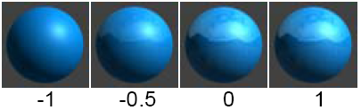

Matte Transp. (Matte Transparency)
A transparent multiplier applied to the surface’s alpha channel in the rendered image. If the Matte Transp. value is 0, an opaque object has an alpha value of 1 (that is, it is entirely invisible when composited). If the Matte Transp. value is 1, an opaque object has an alpha value of 0 (that is, it is entirely visible when composited). For example, to make an object gradually appear during an animation (after compositing), animate the Matte Transp. value from 1 to 0.
The slider range is -1 to 1. The default value is 0.

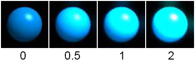

Glow
The Glow parameters define the type of glow produced from light reflecting off a surface, or from surface incandescence.
Glow Intens (Glow Intensity)
The brightness of the shader glow effect. The slider range is 0 to 1. The default value is 0.

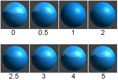

CC Refractive Index
Controls the appearance of clearcoat reflections. A value of 1.6 produces reflections similar to glass. A value of 1.8 produces reflections similar to car paint. This parameter is only available when Clearcoat Material is set to User Defined. The slider range is 1 to 5. The default value is 1.8.

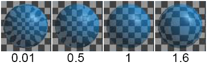

Refractive Index
The amount that camera rays bend when passing through a transparent object.A Refractive Index value of 1 does not bend camera rays at all. Refractive Index values for common materials are: glass (1.6), air (1), water (1.333), crystal (2), diamond (2.417). This parameter is only available when Refractive Material is set to User Defined. The valid range is 0.01 to infinity. The slider range is 0.01 to 3. The default setting is 1.6.
The shader’s Multi-lister swatch only approximates the effect of the Refractive Index parameter.
Surfaces should have thickness in order for Refractive Index to have the expected effect. If a surface does not have thickness (for example, a plane or face element), set the Refractive Index value to 1 and use the Surface Width parameter to simulate surface thickness.
For best results, make sure there are suitable objects in the scene to be refracted.

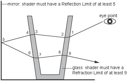

Reflect Limit
The maximum number of times that the surface allows a camera ray to be reflected. For example, if the Reflect Limit value is 4, the surface reflects camera rays that have been reflected (off itself or off other surfaces) 3 times or less; the surface does not reflect camera rays that have been reflected 4 or more times. The valid range is 0 to infinity. The slider range is 0 to 10. The default value is 1.
High values for Reflect Limit greatly increase rendering time. Test render your scene using various settings, and use the lowest values that give you acceptable results. Even highly reflective surfaces rarely need a Reflect Limit value as high as 10 or more.
Refract Limit
The maximum number of times that the surface allows a camera ray to be refracted off itself or other surfaces.
For example, if the Refract Limit value is 10, the surface refracts camera rays that have been refracted or reflected 9 times or less; the surface does not refract camera rays that have been refracted or reflected 10 or more times.
The valid range is 0 to infinity. The slider range is 0 to 10. The default value is 6.

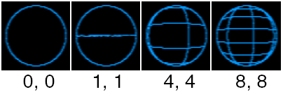

In the following example, a glass sits in front of a mirror.
The number of refractions includes both the entry and exit of a camera ray from a surface having thickness.
The physical property Total Internal Reflection (TIR) can make some transparent objects appear not to refract light. This is a real-world property caused by light rays reflecting inside the thickness of the object. If this occurs in your model, increasing Refract Limit has no effect, because the rays never leave the surface. However, because TIR is a real-world property, you may want to keep this effect. If do not want this effect, increase the Refractive Index.
Tip:
To simulate realistic looking glass, set the Refract Limit value to 9 or 10.

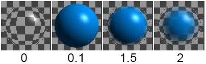

Surface Width
The simulated thickness (in world space units) of transparent objects that are made from single surfaces (for example, a plane or face). The valid range is 0 to infinity. The slider range is 0 to 1. The default value is 0.
Using Surface Width does not produce the same results as building a surface with actual thickness. However, the effect works well when the edges of the surface are not visible (for example, closed surfaces, or bounded shapes like a car windshield).

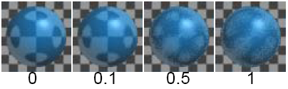

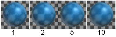

Chroma Abber. (Chromatic Aberration)
Causes different wavelengths of light to refract different amounts when passing through a transparent surface. The valid range is 0 to infinity. The slider range is 0 (no chromatic aberration) to 1. The default value is 0.
Chromatic aberration only affects light rays as they pass through the second surface of a transparent object (that is, the first exit ray). For best results, make sure there are suitable objects in the background to be refracted.
Refrac Jitter (Refraction Jitter)
Randomly alters the direction of refracted light rays. The valid range is 0 to infinity. The slider range is 0 (no jitter) to 1. The default value is 0.
If the Refrac Jitter value is high, you may have to increase the Refrac Samples value to reduce the appearance of aliasing artifacts.
Tip:
Use Refrac Jitter to simulate frosted glass.
Refrac Samples (Refraction Samples)
Controls the smoothness of the Refrac Jitter effect. If the Refrac Jitter value is 0, the Refrac Samples value has no effect. If the Refrac Jitter value is high, you may have to increase the Refrac Samples value to reduce the appearance of aliasing artifacts.
The valid range is 1 to infinity. The slider range is 1 (rough) to 10 (smooth). The default value is 1.
Use Refl. Map (Use Reflection Map)
Causes the surface to have reflections from the Reflection map only. If Use Refl. Map is OFF, the surface has reflections from all of its surroundings, but not from its Reflection map. The default setting is OFF.

U Patch Lines, V Patch Lines
The number of lines shown on the surface in its U and V directions during hidden line rendering. The valid range is 0 to infinity. The slider range is 0 (no lines shown on the surface except for edge lines) to 8. The default value is 0.
