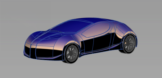

User-defined Texture diagnostic shader
Displays a user-defined texture reflected on the selected surfaces. Use one of the two default textures, or load one of your own.
This mode shows a user-defined texture reflected on the picked surfaces. You can use one of the two default textures, or load one of your own.
