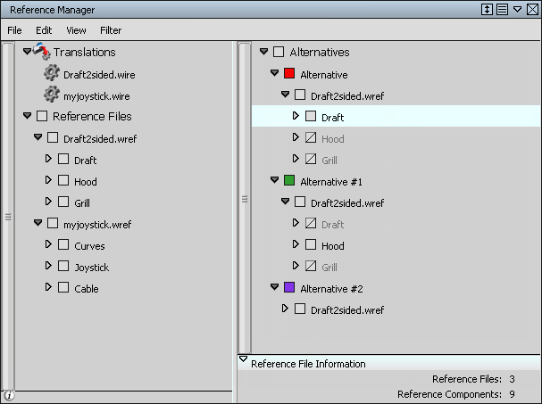

File > Reference Manager
Lets you import reference data for use in two major workflows: Importing large amounts of engineering data while maintaining interactive performance, and importing large amounts of design data and providing alternative shading and comparisons for design reviews.

Reference Files
Shows only the left side of the Reference Manager window.
Alternatives
Shows only the right side of the Reference Manager window.
Both
Shows both sides of the Reference Manager window (Reference Files and Alternatives).
+/- All
Expands or collapses the content of all the reference files and Alternatives.

Right mouse button menus
This section describes the choices from the menu that appears when you right-click various items (reference file, alternative, layer, etc) in the Reference Manager.

Reference Files
Visible
Toggles the visibility of the reference file. The file is visible when the check mark is displayed.
Remove File/Remove File from Alternative
Deletes the reference file from the Reference Manager.
If the file is inside an Alternative, it removes it from that Alternative only.
Show All Layers
Makes all the layers under that reference file visible.
Note:
If you right-click Reference Files at the top level and choose Show All Files, all reference files become visible.
Alternatives
Visible
Toggles the visibility of the Alternative. It is visible when the check mark is displayed.
Remove Alternative
Deletes the Alternative.
Revert Transform
Undoes all the transformations (move, scale, etc) applied to the Alternative and returns it to its original state.
Show All Files
Makes all the reference files under that Alternative visible.
Note:
If you right-click Alternatives at the top level and choose Show All Alternatives, all Alternatives become visible.
