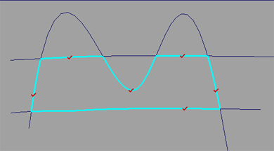

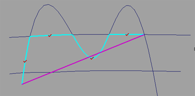

Certain shapes require selecting a curve in more than one location. In the example below, let’s say we want to create a Shape Fill for the region outlined in red.
(This workflow also applies to any of the Paint > Shape > tools).
The Shape Editor opens.
Small check marks show the points where you clicked. A thick line marks the outline of the shape defined so far.
The correct shape is created.
