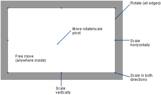

    A manipulator appears on the active image layer.
  4. Click and drag a manipulator handle to transform the image layer.
    When you move the mouse over the manipulator, a context-sensitive cursor shows the current transform mode (move, scale, rotate).
