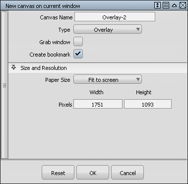

The option box opens. If you select a brush and click in a view that does not contain a canvas plane, Alias automatically opens the New Canvas option box, prompting you to create a default canvas plane.
A blank canvas plane containing one canvas layer and a background layer is created in the view you specified. The new canvas appears in a special Paint window, on top of the regular view window, ready for sketching.
If you chose the Paint workflow setting when you launched Alias, choosing File > New opens an option window allowing you to select the parameters (color, orientation, width, height, etc) for a new canvas. All other canvases are removed.
The new canvas appears in a special Paint window, on top of the regular view windows, ready for sketching, just as when using Canvas > New Canvas
