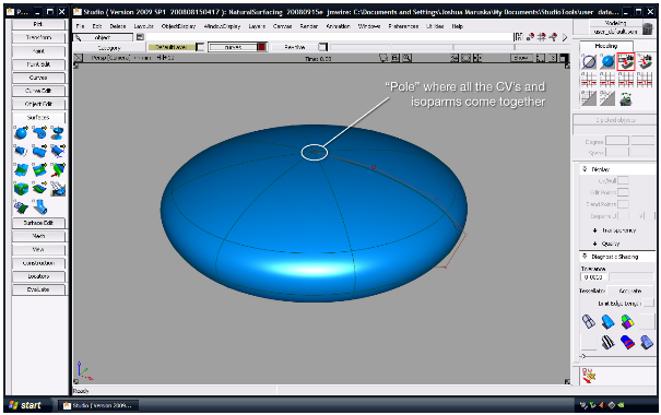

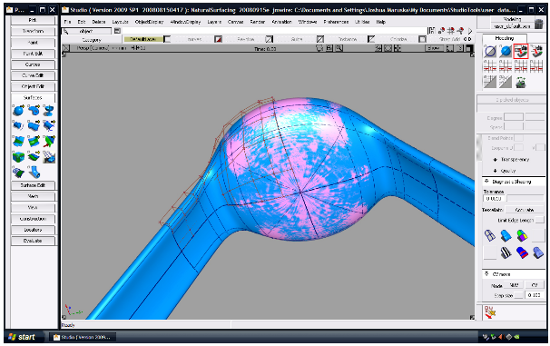

The biggest challenge when working with revolved surfaces and spheres is the "pole". This is where all the CV's and isoparms come together. If you've ever picked apart one of these surfaces, you'll know that the poles are a nasty dirty mess. There are many things all piled on top of on another.
The problem with poles are that trying to extract surface direction from them can be difficult. The UV directions are heading everywhere and nowhere at the same time which will give tools like Align or Blend Curves nightmares in trying to resolve the situation. I'll go to great lengths to not have to deal with this type of thing.

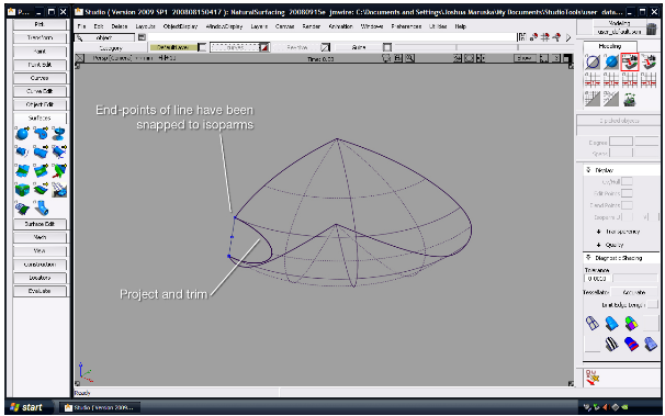

Here, I've done a few things: I detached the revolved surface such that only a quarter of it is left; I've snapped a line to the two middle isoparms; projected this line onto the revolve along the X axis and then trimmed it.
The end result, is one side that has the desired cross-section profile, and two edges (interrupted by the trim) that are a single span each. The fourth edge (the result of the projected curve on surface and trim) won't be used in the following steps. It's a trimmed edge, and building from trimmed edges are generally something I'll avoid until very late in a model build.

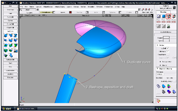

I often make little temporary surfaces to build from. I'm not sure if they have a proper name, but I call them stub surfaces. Usually they get deleted after they serve their purpose.

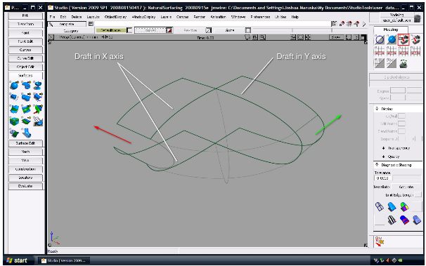

These particular surfaces will be used as guides to build what will become the main body of the watch or 'Master' surface. They were created using the Draft tool (one of my favorite tools) in each the X and Y directions. Notice how the isoparms of the Draft surfaces match the isoparms of the reference revolve.

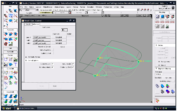

Here I create the start of the Master Surface using the Birail tool. The generation curve references the edge of the stub surface created from the untrimmed edge of the revolve. The rails reference the other two edges with one span each.
Again, notice that (as long as 'rebuilds' are off in the Birail tool) the edges of our new surface reflect the span structure (and thus CV placement) of the stub surfaces which in turn have inherited their structure of the revolved surface.

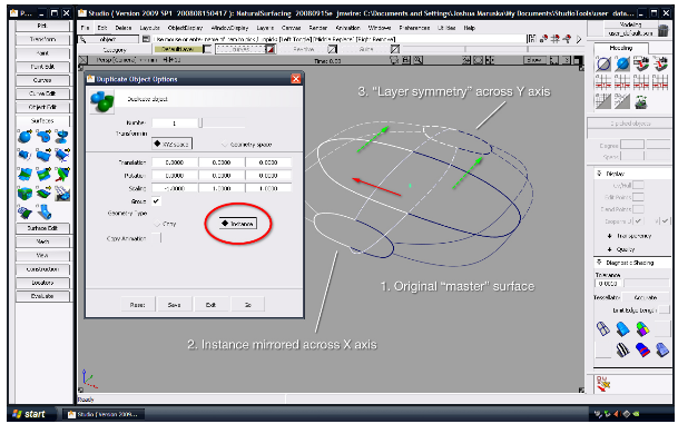

AliasStudio has some nice two-way symmetry tools in the Layer Symmetry option. Just put some geometry on a layer, turn symmetry on and you have a 'live' mirrored reference. Any changes you make to one side, are made to the other. But what about 4-way symmetry (or more)?
Fortunately we can use 'instances' to achieve a similar effect.
Here, I've started with my railed Master Surface and then using the Duplicate Object Options, I enter -1 in the X scale parameter (to get the mirror) and change 'Copy' to 'Instance'. An instance is like a virtual copy. You can't modify the instance, but you can modify the original from whence it came- thus aping the 'live' effect that Layer Symmetry offers.
In this particular case, I've combined an instance with the layer symmetry to get 4-way symmetry. There is only one surface in this scene that can actually be modified, but all four quadrants will change when it's tweaked.

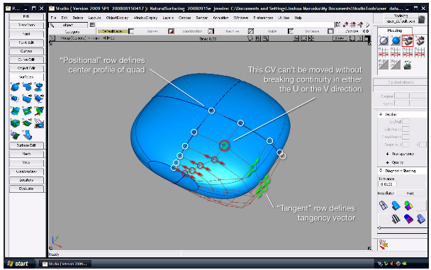

Before we start modifying our shape, I wanted to establish some ground rules for manipulating CV's on a surface.
I like to think about CV layouts in terms of rows. The CV's that exist at the edge of a surface define that surface's edge profile. If the CV's are in a straight line, the surface's edge will be a straight line. This is the 'Positional Row'.
The next row in, the second row of CV's, are the 'Tangential Row'. This row defines the 'vector' at which the surface terminates. If all these CV's are aligned in a horizontal plane relative to the 'Positional Row' then your surface will be tangent to a horizontal plane adjacent to the surface's edge.
These two rows are well within a human's ability to control manually. The next row in, the third row of CV's, are the 'Curvature Row'. Without getting into a whole discussion about 'what is curvature continuity', we'll just say, in most situations, it's improbable and impractical that anyone would model two adjacent surfaces to curvature continuity without the aide of computer control. The math is just too great.
There are two situations where this isn't true. The first is; that to be curvature continuous with a flat plane requires that the first three rows of CV's be in that same plane. The second is when dealing with symmetry. By definition, a surface mirrored about it's edge will be curvature continuous to itself along that edge (assuming the edge was at least perpendicular to the plane of reflection). It may not be pretty, but it will be mathematically correct.

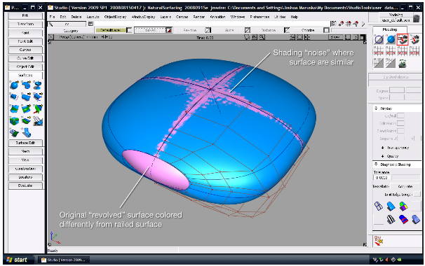

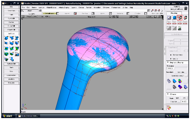

Let's start sculpting. I've brought back the original revolve in it's entirety. We will be using it as a guide to help us shape the Master Surface. To facilitate this, I've colored the revolve a different color than the Master Surface. You will immediately notice that the revolve shows through in areas, but in a fuzzy, noisy kind of way.
This is an artifact of shading in 3D programs. It's probably a bug, but I've never seen any 3D software that doesn't do this, so I've taken to using it as a feature.
The premise is simple, when two surfaces have nearly the same topology, the computer can't decide which one to bring to the forefront to shade first, so it shades them both and makes this noisy pattern. In this case, this is how we'll know when our Master Surface is approaching the right shape. We see the noise at the edges of each quad because they currently use the same CV placement at those edges. The rest of the surfaces are quite different from one another so we don't see anything other than the front most/outer surface.

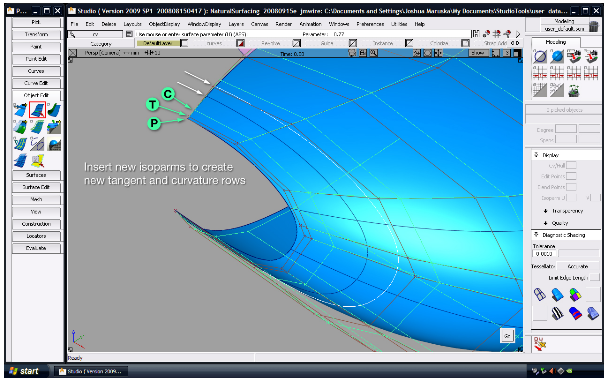

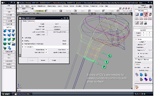

If we were to just align the Master Surface to the strap at this point, most of our CV's that define the median profile would be swallowed-up by the alignment resulting in quite a loss of our overall shape and the need to rebuild and tweak more than necessary. Anytime you move a CV, it has 'influence' both upstream and downstream from itself. The higher the degree of the curve or surface, the more broad this influence can be.
By inserting two isoparms (Object Edit > Insert) close to the edge of the Master Surface we gain a couple new rows of CV's. We have the existing Positional row and now new Tangential and Curvature rows close to the edge we'll be aligning. We'll still lose some shape due to stretching, but much less than we would have if we had just let the original rows to become aligned with the strap.
Next we align that edge with the new isoparms to the edge of the strap surface we made earlier and we have the start of our fluid watch shape.
The CV rows that were so close together in our previous step are now spaced far apart and make an elegant transition into the head of the watch. While we still have construction history for the alignment, we can move the CV's around. They will snap back to the next closest position in space that still meets the requirement of the align, so if your CV's are too close or too far, a quick manual adjustment will get them looking right.
As an aside, I find that the "Align 2008" works better for this type of modeling approach, where as the new Align tool in AliasStudio 2009 works great on trimmed surface edges.

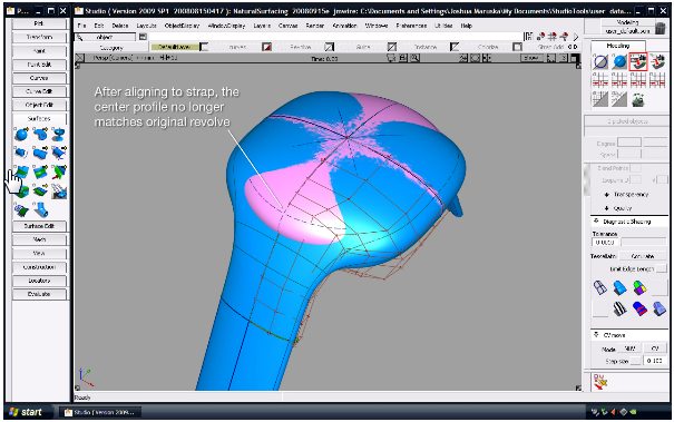

Before we start tweaking, I wanted to show what the surfaces look like after the strap transition alignment.
In earlier stages, the median profile was much closer to the underlay and now it is very different. We could have added more isoparms to the surface prior to the align, but that would have also meant more CV's for us to deal with, so in the interest of CV conservation, I didn't add any more isoparms than I needed at that point.

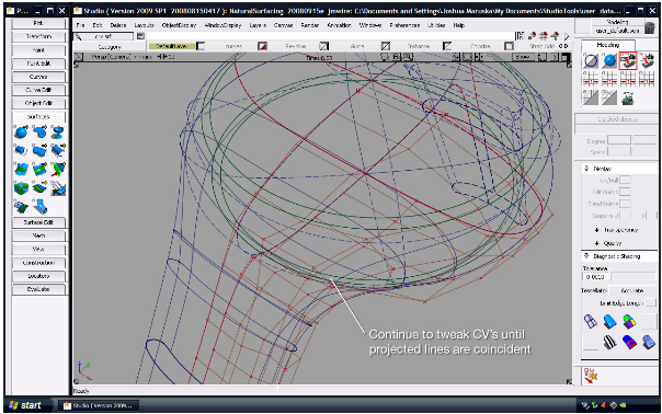

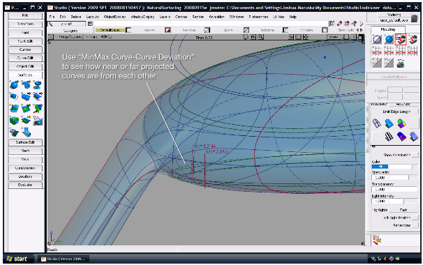

Often times, a visual inspection of the surface won't be enough. In this case, I plan to have some elements of the design that will need to perfectly mate together.

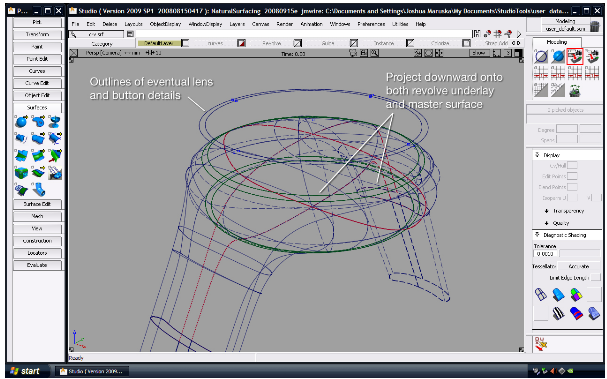

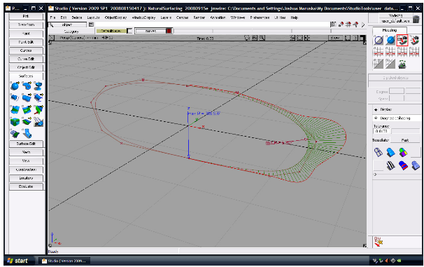

I am assuming that this watch will have a ground glass lens. Because of the way watch crystals are made, the lens will have to be a perfect revolved section. Fortunately, we started with one of those. But how can I be sure the Master Surface and the revolved section will meet perfectly at the adjacent edge?
By projecting a line (in this case a circle - or two) onto both, I now have a common reference point by which to judge.
With both the revolve and Master Surface sporting projected Curves on Surface, I can now add a deviation measurement using "MinMax Curve-Curve Deviation" in the Locators palette.
I can see that one of my circles is off by only 0.0766 mm but the other is off by 0.2144 mm. I would prefer to have these values below 0.01 mm - a value that will be far below the manufacturing tolerance of the parts.
We still have some work to do.
With some additional work, our projected curves are within acceptable tolerance of each other.

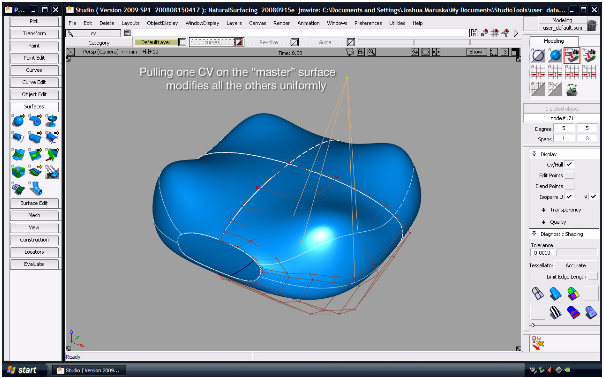

Again, there is no magic trick, just persistence. One of the things that I try to do while CV tweaking is to maintain uniformity of each of my rows - both along the U and the V of the surface. I generally don't make huge adjustments to just one CV, but rather 'creep-up' on the desired form by moving each CV just a bit. I usually find working in a radial pattern out from the most misaligned portions a good approach. This prevents the tendency to over-adjust one CV and then over-compensate with CV's surrounding it.
Think of the array of CV's around your object like a cage that floats just off the surface. This cage really defines your shape and there fore shouldn't be much different.

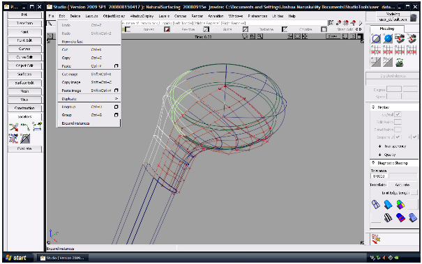

Using "Expand Instances" will convert the selected instance from a virtual copy into real geometry. With this relationship broken, any changes I make to one side, will no longer be reflected in the other.
I have also turned-off the layer symmetry option.
No instances. No layer symmetry. What could be next? Something decidedly unsymmetrical, I suppose...

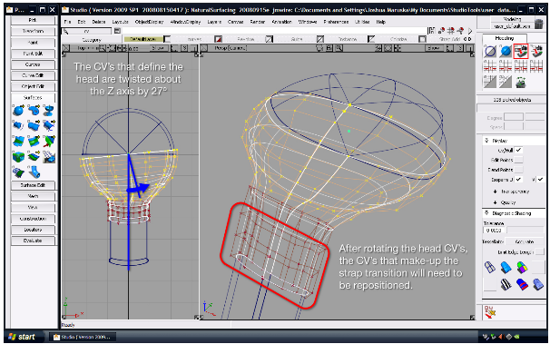

Here, I grab the CV's that make-up the majority of the watch's head and rotate them about the Z axis. In case you were wondering, the head in the final model is rotated 27 degrees. I did this by typing the values 0,0,27 after selecting the rotate tool. Be sure to be set to 'relative' mode or CV's will move in unexpected ways.
I will then grab the remaining CV's and twist them over and downward to smooth out the strap transition again. Think about you CV's in blocks or masses. The three rows of CV's at the end of the strap would be good example of CV's that should be moved as one 'unit'. The head CV's are another.

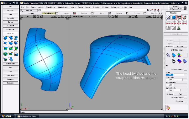

Boom. That's quite a bit different from where we started from. It's still pretty rough, but in the next part this series we'll be looking at a variety of techniques to continue tightening-up the model.
I hope this shows some of the advantages of working with this method of surface development. If this model had been constructed using several surfaces knitted together with little blends and transitions, it would have been very time consuming to make a broad sweeping change like this.
