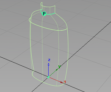

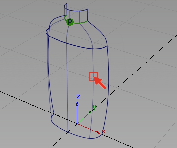

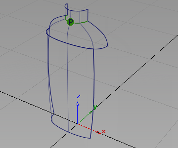

To make space for the finger grip, split the body surface, and discard the part you are replacing with the grip feature.
Because the isoparms on the surface are at a convenient location, you can use the Detach tool to split the surface at an isoparm. You can snap to a particular isoparm, using the
(Windows) or
(Mac) key.
Before detaching, delete the construction history of the surfaces.
Detaching leaves a good quality edge on the surface. However, it is not reversible, so we recommend that you save before using Detach.

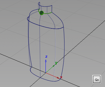

Move the mouse to check that the detach tool has locked on to the isoparm.

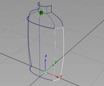

The isoparm is highlighted and a Go button appears.

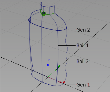

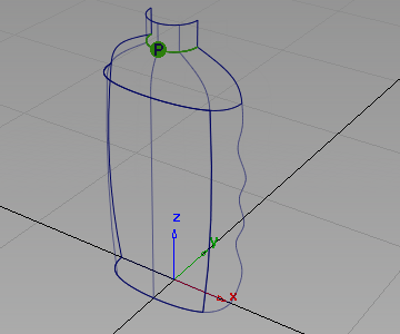

A curve has been provided on the GripCurves layer to define the profile of the finger grip.

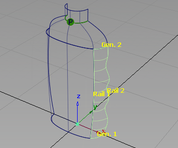

Now create a Birail surface for the finger grip. Make the Birail tangent to the edge of the body surface and tangent to the shoulder surface. Match the birail surface to the curve at the base with positional continuity, and have Implied Tangency on the finger grip curve, where you later mirror the surface.
In the Generation Curve section, choose 2.
In the Rail Curve section, also choose 2.
Choose Go Position for each of the four Continuity options (you can change these options after the Birail surface is created).
If any of the Rebld boxes are checked, click them to remove the check.
The Rebld option can improve the parameterization of an edge, typically a trimmed edge. As all your edges and curves have good parameterization, do not use it in this case.

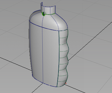

The birail surface is created.

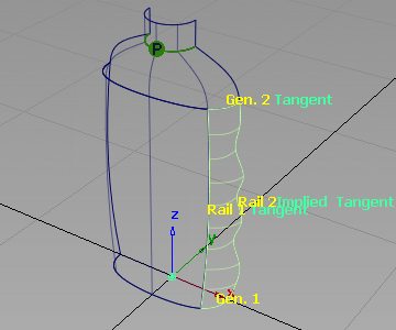

With the surface still selected, and the option window still open on screen, you can now adjust the continuity options at each edge.
| gen2 | G1 Tangent |
| rail1 | G1 Tangent |
| rail2 | Implied Tangent |
The surface is rebuilt with the new continuity settings.

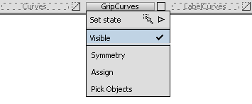

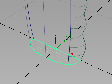

Use the Show menu on the window pane to turn off the model and the grid. Remember to turn them on again when you remove the shading.

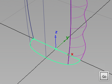

Create the base of the bottle as a flat plane.
You can use the space bar as a short cut instead of clicking Go.
