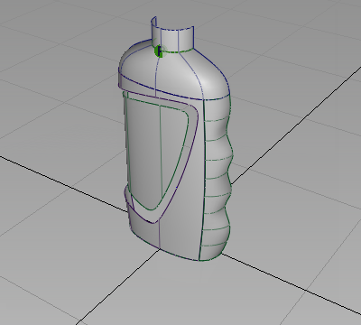

First, trim out the label shape from the main body surface.
Then, create a recessed surface for the label panel. Trim this surface slightly smaller so there is a space to build a smooth blend surface.

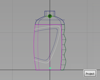

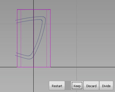

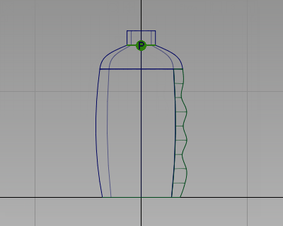

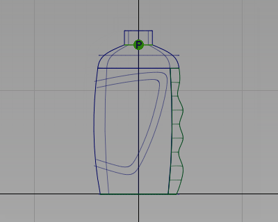

First project the label shape curve onto the bottle surface. The active window determines the projection direction, so use the Left window.

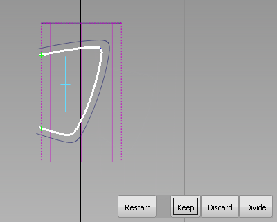

The layer has two curves for the outline of the label. Use the outer curve to trim away the main body surfaces.

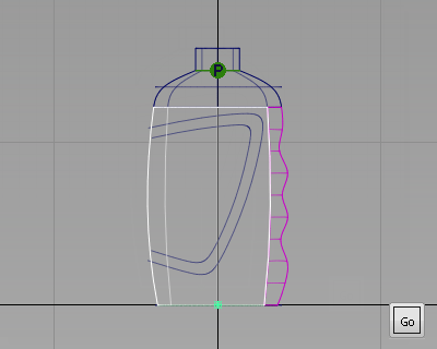

You are prompted to select a surface. Click the main bottle surface to select it.
You are then prompted to select the projecting curves.
The curve is projected onto the surface.

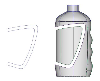

You are prompted to select the surfaces to trim. Click the main bottle surface to select it.

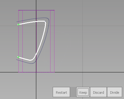

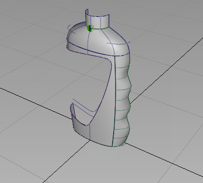

The surface is trimmed.
If the trimming is not correct, click Revert at the bottom of the screen to go back one step and reselect the trim regions. If you want to correct the trim at a later stage, you can use Surface Edit > Trim > Untrim to restore the surface to its untrimmed state.

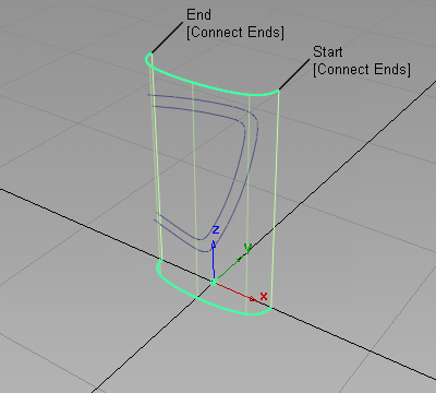

The bottle is to have a paper label. Paper can only bend in one direction at a time if it is to have no folds or wrinkles. Therefore bend the label surface only in one direction. This is called single-curvature.
Create a single-curvature surface by using a Skin surface between two identical curves.

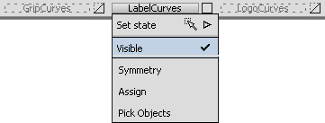

First, organize your model using the layers.

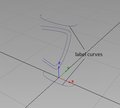

There are two identically shaped curves for the skin surface; use these curves to create the label.

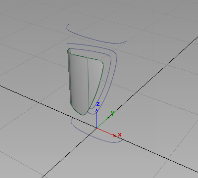

Next, project the label outline curve onto the surface and trim the surface to the shape of the label.

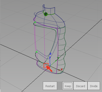

This time execute both operations at once by using the 3D Trimming option in the Trim Surface tool.

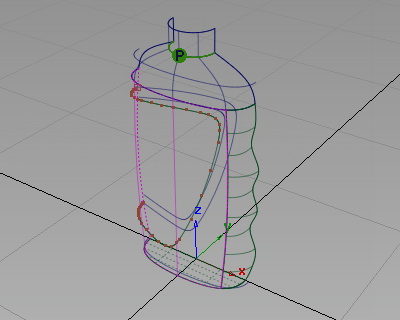

Select 3D Trimming, then close the control window.
You are prompted to select trimming curves.

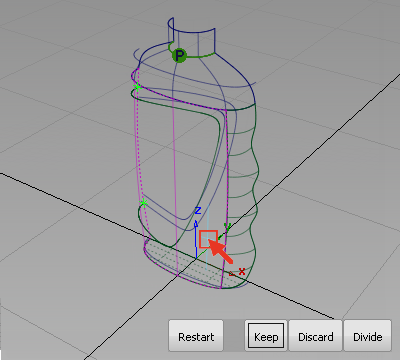

You are then prompted to select trim regions.
