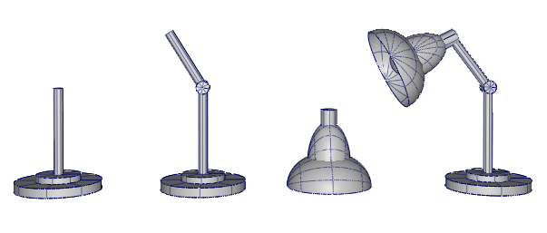

First create a base from cylinders. Then build a moveable arm at an angle, also using cylinders. Finally, build a lampshade using spheres, and then assemble it onto the arm.

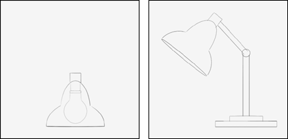

To help you build the desk lamp model, an exercise file has been provided which contains outline sketches of the design.

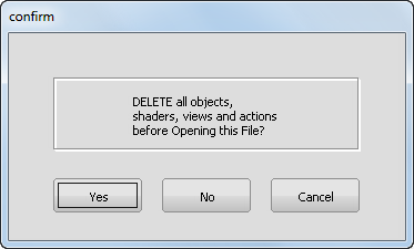

When prompted to delete all objects, click Yes.

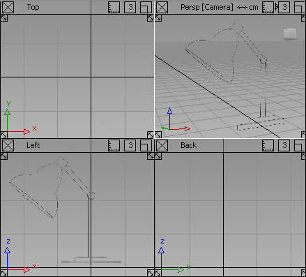

The file browser closes and the desk lamp exercise file appears in the Alias window.
A sketch of the desk lamp design displays in the Left view. This sketch is a reference image, known as a canvas plane. In the next part, use it as a guide to model the desk lamp.
If the two sketches do not appear, it is because the canvas plane display has been turned off. To turn on canvas display, choose WindowDisplay > Toggles > Canvas Planes
If you do not see any views, or the views do not take up the full view window space, choose Layouts > All Windows > All Windows
