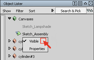

In this part of the tutorial, organize your model by grouping. One group forms the base of the lamp, the other group forms the angled arm and hinge. Name and manage the groups using the Object Lister. The Object Lister is a schematic view of the objects in your scene. It is useful for managing the components of a design.

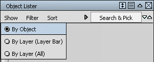

Use the Object Lister to turn off the sketch, making the geometry easier to select.

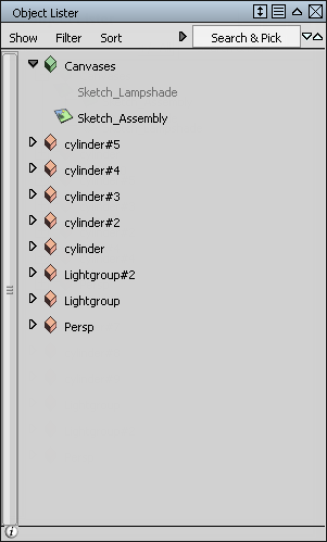

The objects in your scene are listed.
The sketch is shown at the top of the list, followed by the cylinders you created.

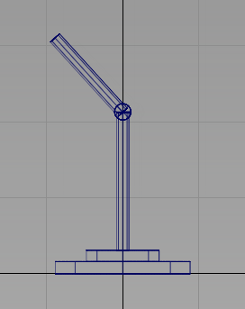

The sketch disappears from the screen.
Make the sketch visible again by selecting the same submenu and choosing Visible.

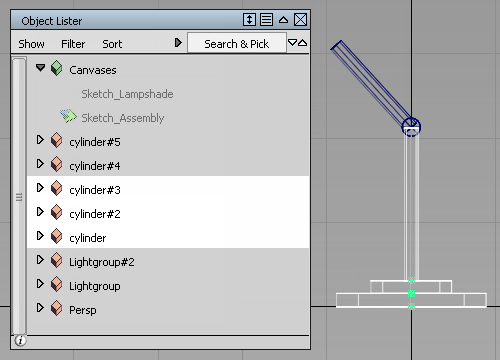

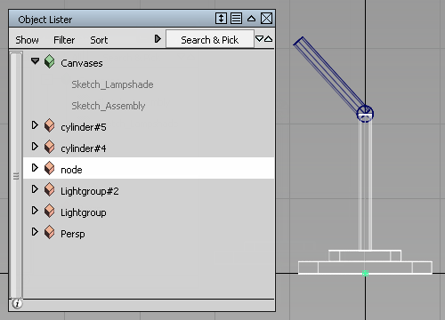

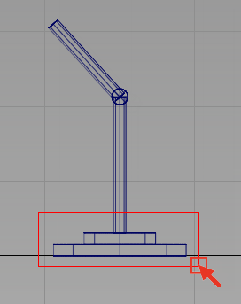

Group individual objects so they can be selected with a single click. A group has a single pivot point.
The selected objects are highlighted in white and are also highlighted in the Object Lister.
Each cylinder shows a different pivot point.

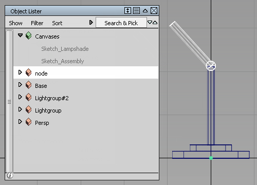

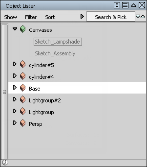

The grouped objects are now shown with a single pivot point at the origin. The separate cylinders in the Object Lister are replaced by a single item named node.

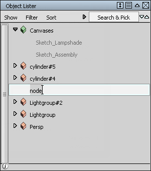

The word node is highlighted. Type Base to rename the group, then press
(Windows) or
(Mac).

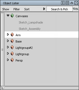

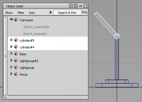

Next, group and name the upper arm of the lamp.
If there are any problems, ungroup the models and use Transform > Move and Transform > Scale to adjust the model. Then, group the components again, as before.
