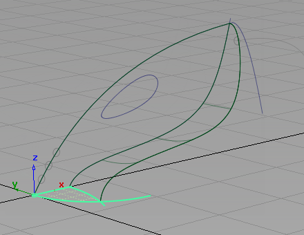

Now, intersect the upper and lower surfaces to create the body shape.

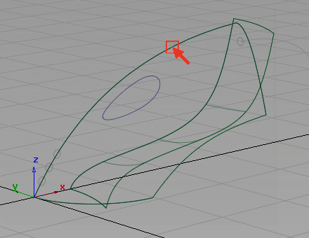

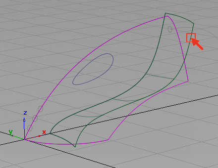

Use the
to click the upper surface to select it. If the pick chooser appears, pick the rail surface, not the curve.
The surface is highlighted and a Go button appears in the lower right corner of the view.
Click Go to select the first surface to intersect.
The surface is highlighted in pink.

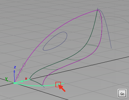

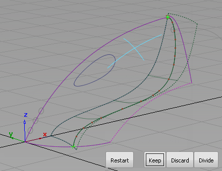

Click the lower surface to intersect it with the upper surface.

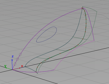

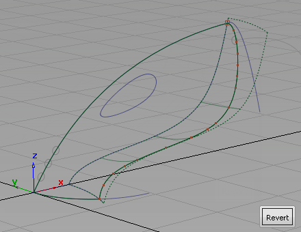

The surfaces are intersected. Two curves-on-surface are created, one on each surface.
By default, the Intersect tool creates a curve-on-surface on each surface so each surface can be trimmed.
Both surfaces are now drawn with a dotted outline to indicate that each has a curve-on-surface.
The highlighted curves that appear are the two curves-on-surface. It looks as though there is only one curve-on-surface, but there are two in the same location, one on the upper surface, and one on the lower surface.

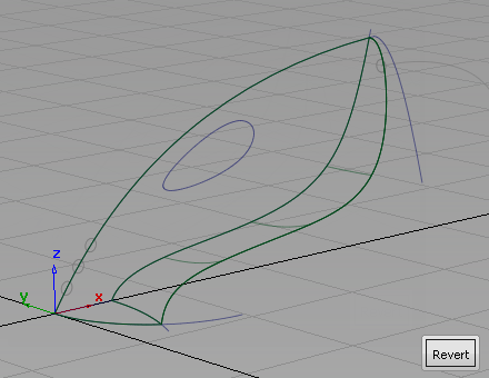

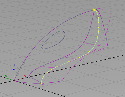

Now, trim off the excess from the upper and lower surfaces.

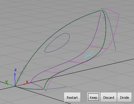

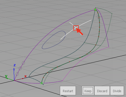

A trimmed surface is not cut; it exists in a hidden form that does not render or affect modeling. While performing a trim, you can easily discard part of a trimmed surface by selecting the unwanted portion of the geometry and clicking the Divide button that appears at the bottom right corner of the screen.

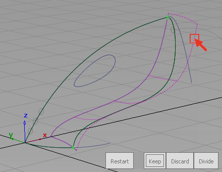

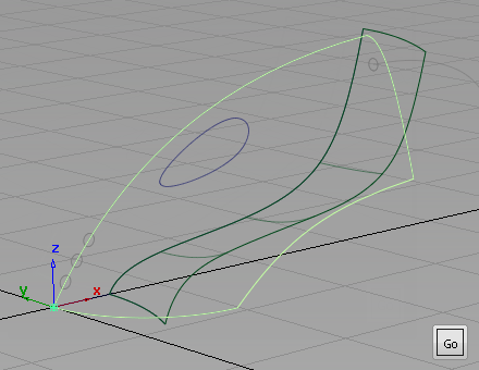

Pick the upper surface.

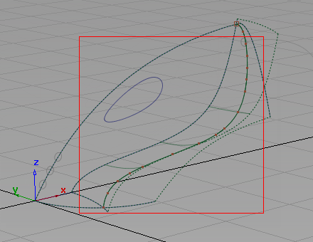

Shift select to add or remove surfaces or click or box select to select trim regions.
The last option allows you to trim away the excess parts of the surface, so respond to this prompt.

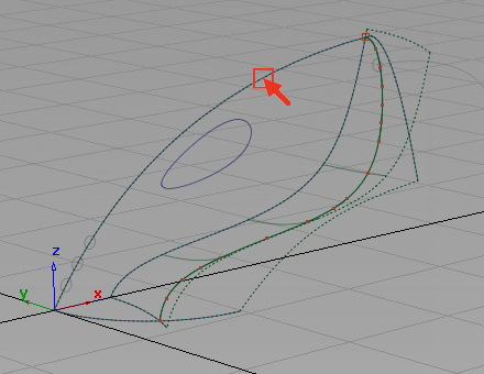

Click any part of the upper surface on the inside part that you want to keep.
The Trim tool places an indicator where you clicked and the buttons in the bottom right corner of the view become available.

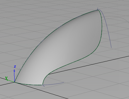

The upper surface is trimmed.

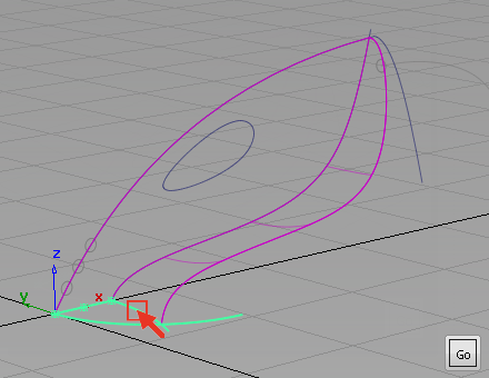

Next, create a planar surface across the mouth of the nozzle to complete the exterior shape of the vacuum body.
You are prompted to select a curve.
The curve is selected and a Go button appears in the bottom right corner of the view.

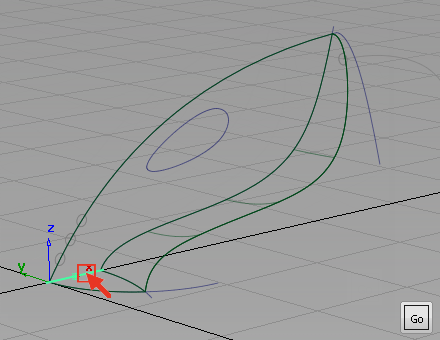

You are prompted to select another curve.
The curve is selected, and you are prompted to select another curve.
The curve is selected. The three curves form a closed region within which the planar surface is created.

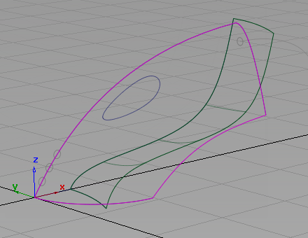

The surface is created and displays with a yellow grid.
