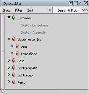

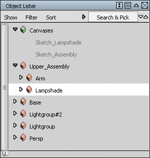

The groups you created previously are still in the model.
to the left of Upper Assembly. The Lampshade and Arm subgroups are shown.

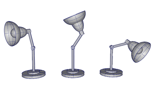

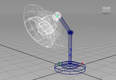

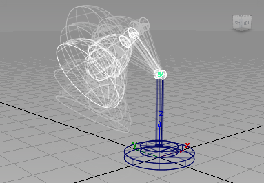

These groups and subgroups allow you to move and rotate different components of the lamp.
You can position the lamp in many different poses, by picking and rotating individual groups around the x, y, and z axes.

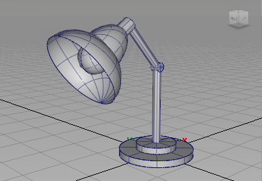

The wire model can be shaded to give a more realistic view of the geometry. Access diagnostic shading in the Control Panel to the right of the Alias interface.
If the panel is not shown, choose ObjectDisplay > Diagnostic Shading
to make it visible.

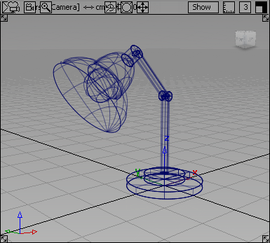

To return to the wireframe view, choose the wireframe icon
