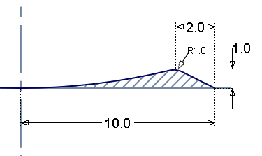

The following image shows a cross-section of the Navigation Key. Build only the part of the key is seen above the casing.
The following image shows the dimensions for the Navigation Key profile. Revolve this profile to create the button surfaces.

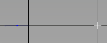

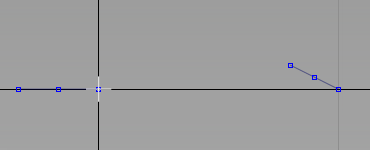

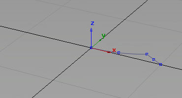

First create a construction line to specify the tangency for the center of the button.
It can be useful to turn off the guidelines when you are using Keypoint curves. To turn off the guidelines, choose Preferences > General Preferences
to open the option window. In the Modeling section, enter zero for the Maximum Number of Guidelines. Entering zero prevents any guidelines from being created.
Use the
to place the second point of the line horizontally to the left of the origin. The length of the line is not important, as you use it only to help create a tangent arc.

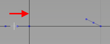

Now draw the line for the outer chamfered edge.
When prompted to place the end point of the line, type in R-2,0,1.
The letter R is used to switch from ABSolute to RELative dimensioning.

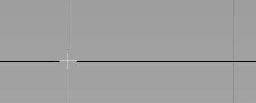

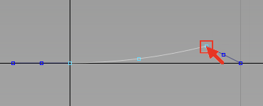

Now create an arc for the center of the button.
Select curve at location to make arc tangent from.

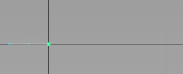

Click the first line, and without releasing the mouse button drag the start of the arc to the end of the line at the origin.

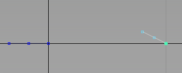

You are prompted to enter the end point of the arc. Use the
(Windows) or
(Mac) key) to place the end point of the arc on the top keypoint of the angled line.

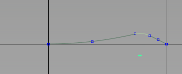

Change the Radius to 1.87 and click Go.
Follow the prompts to create a 1.87-mm radius fillet between the curves and click Accept.

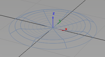

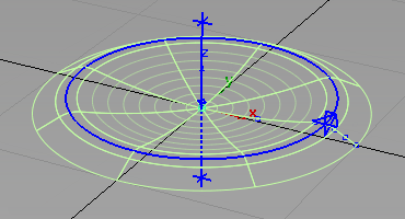

Now revolve the profile curves to create the button surfaces.
to deselect all curves.
Set Segments to 8.
Under Axis Options, set Axes to Global, and select Z as the axis of rotation. Using global axes allows you to revolve many curves at once, around the origin, not around the pivot point of curve.
Turn off Continuity Check.

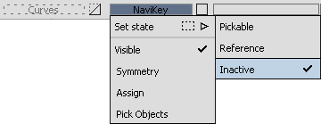

Assign the grouped surfaces to the NaviKey layer, and make it inactive.
