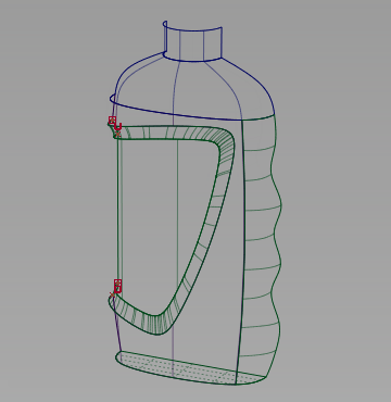

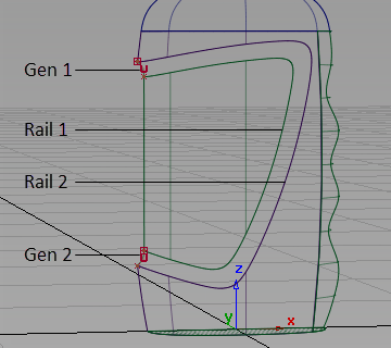

The label surface is recessed back from the main bottle surface. The gap between the two surfaces is bridged by a Birail surface, which gives the label area its character.
To create the Birail, use the two trimmed edges as Rails, and create two new curves for the Generation curves.

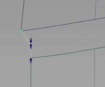

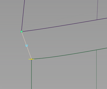

Previously, you used the Align tool to create tangent continuity between two surfaces. Now, use the Align tool to create a tangent relationship between a curve and the edge of a surface.

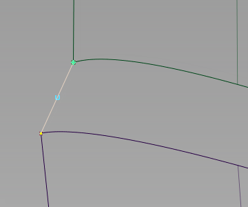

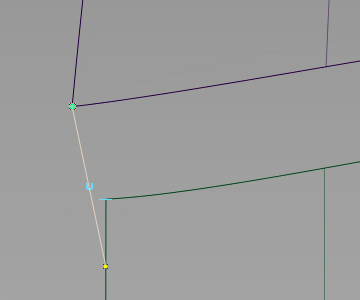

To keep the Birail surface smooth and taut, use a curve with only 3 CVs to define the character of the blend. Two CVs control tangent continuity to the label surface, and the third controls positional continuity to the body surface.
Using the minimum number of CVs needed in a curve or a surface helps to keep your model light and smooth.
to open the option window. In the Curve Degree section choose 2 and click Go to create a single-span curve with only 3 CV points.

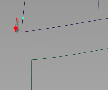

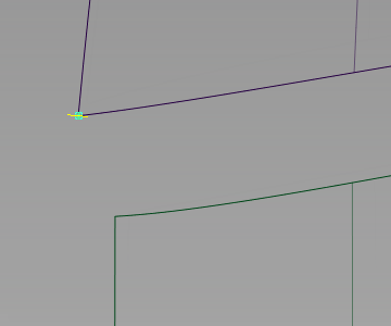

The first edit point of the new curve is placed.
The Birail tool requires that all boundaries are accurately aligned, so it is important that the curve is snapped accurately to the corner.

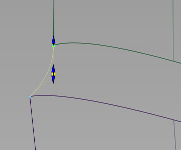

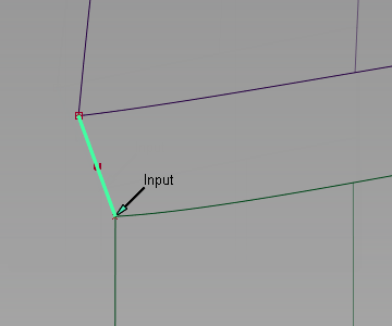

to open the option window. In the Continuity section, choose G1 Tangent.
Click the vertical edge of the label surface, near the curve.
The curve is adjusted to be tangent to the surface.

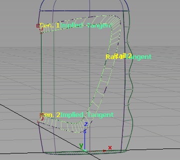

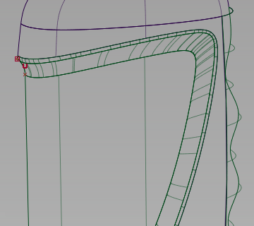

to open the option window. | gen 1 | Implied Tangent |
| gen 2 | Implied Tangent |
| rail 1 | G1 Tangent |
| rail 2 | G0 Position |

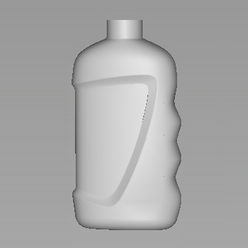

The Birail surface is created.

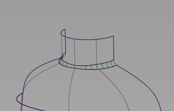

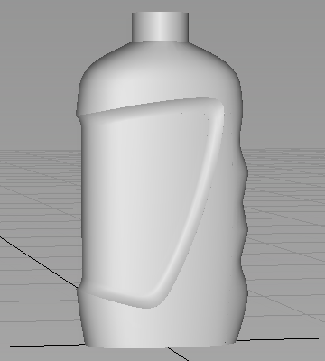

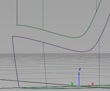

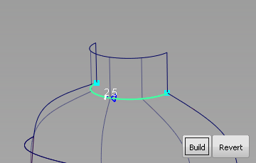

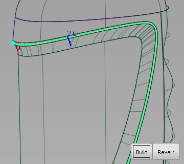

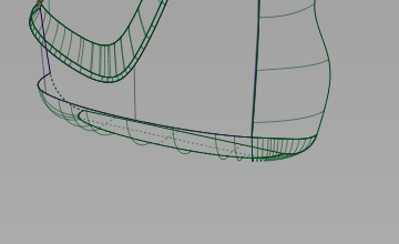

To complete the model, soften all the sharp edges with Round surfaces.

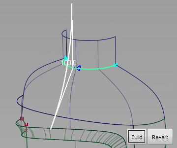

Click the edge between the neck and the shoulder surfaces.

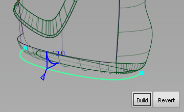

The default radius value is shown, and highlighted in white.

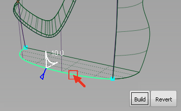

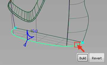

As there are two edges at the base, click first on main bottle surface edge.
Type a Radius value of 10.
Then, click the edge created by the finger grip surface and the base to build the round surface along both edges.
