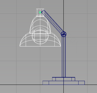

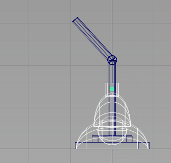

In this section, assemble the finished desk lamp by moving the lampshade into the correct position and grouping it with the upper arm.
Next, group the lampshade to the arm, so the lamp can be moved and arranged.

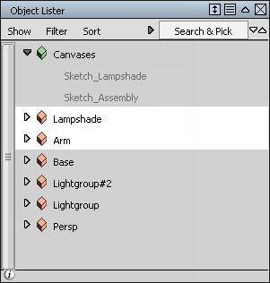

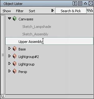

The two groups are highlighted in the Object Lister.

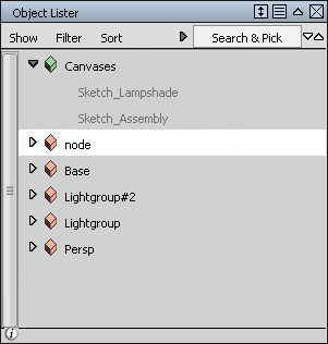

-click on the selected objects in the Object Lister and choose Group from the drop-down menu (or choose Edit > GroupA new node is created and displayed in the Object Lister.

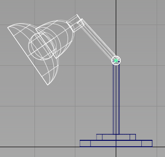

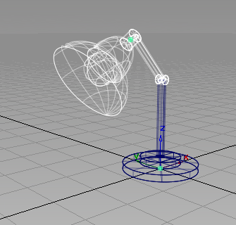

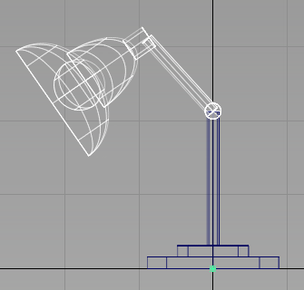

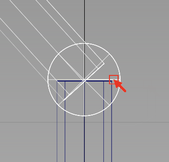

The group is created with the pivot point in the default location, at the origin. To ensure that the upper assembly rotates correctly, move the pivot point to the center of the hinge.

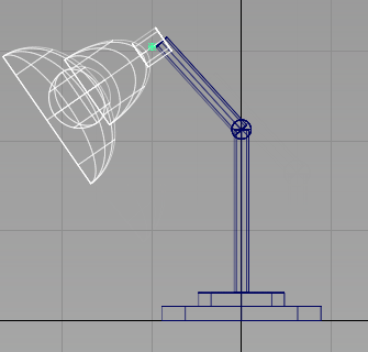

The pivot point moves to the center of the hinge.
