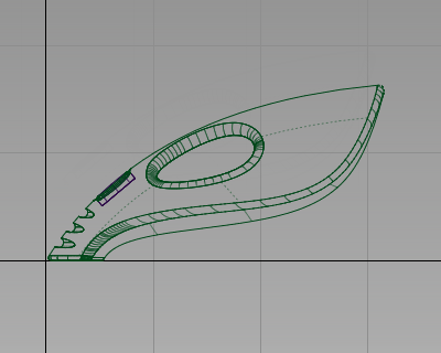

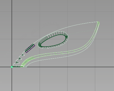

At the back end of the vacuum cleaner there are two more components, a dust bag and a cable connector, shown in the following image.
Create these components as scaled copies of the rear surfaces of the main vacuum cleaner body. By using the same shape, you create a rhythm of similar shapes, which gives the design its character.

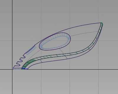

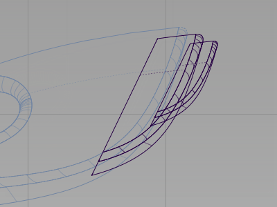

Start by creating copies of the body surfaces and placing them onto a new layer.
Now make a copy of the surfaces and assign them to the dustbag layer.
The layer tab is displayed in blue to indicate that it is inactive.
Now, only the copied surfaces on the dustbag layer are displayed and pickable.
Only the ends of the body surfaces are required for the dust bag and cable connector.

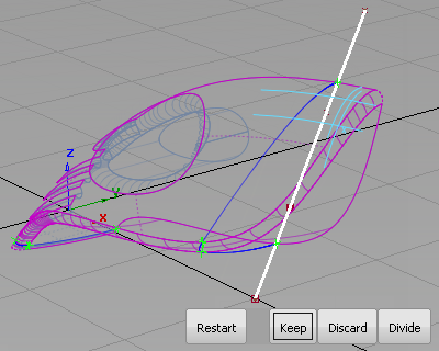

Next trim the surfaces so only the rear part of the shape is left, to make the surfaces easier to work with and easier to visualize.

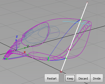

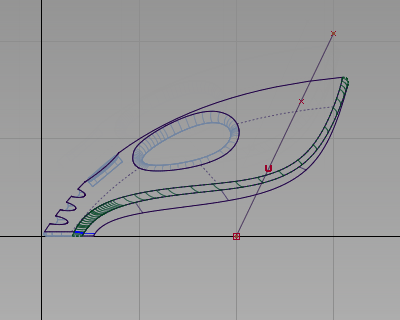

Trim the surfaces by using a curve to define the cutting line.

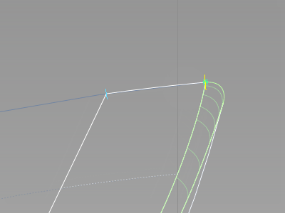

You are prompted to enter the new edit point position. Hold down the
(Windows) or
(Mac) key and click near the grid intersection shown in the following image to position the first edit point of the curve.

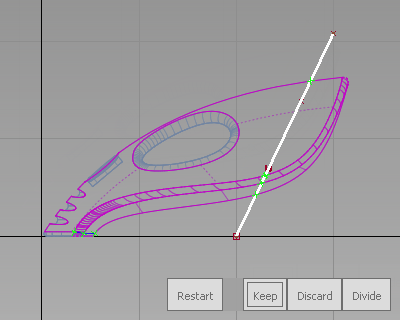

Place the second edit point by clicking and holding the
. Keep the mouse button held down and move the edit point until the curve is roughly at the same angle as the back of the vacuum.
Make sure that your curve is long enough to extend beyond the body surfaces.

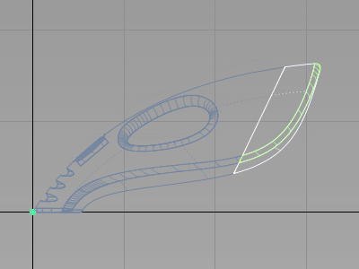

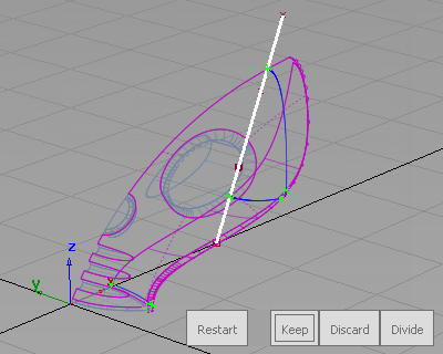

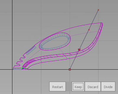

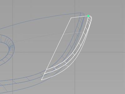

The Trim tool can be used to create a curve-on-surface directly from a projected curve before trimming the surface. Now use the curve you have drawn to cut away the front end of the surfaces.
The surfaces are selected and highlighted in pink.
You are then prompted to select one of the following:
Shift select to add or remove surfaces or select trimming curves or click or box select trim regions.
This time, use the Trim tool to project the curve onto the surfaces, and so respond to the second prompt.
You can see that a curve-on-surface has been created across the surfaces and is shown in bright blue.

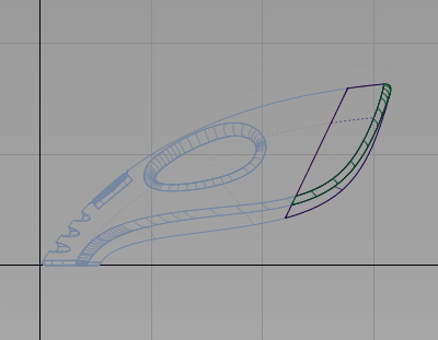

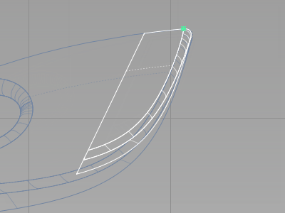

Still in the trim tool, you are now prompted with the three options. This time you want to select a region of each surface to keep.
An indicator appears on the surface to show that it is selected for trimming.
Zoom in to make it easier to select a part of the fillet surface with no lines.

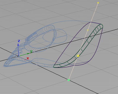

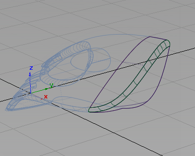

The surfaces are trimmed.
Choose Delete > Delete Active
, or press the
key on the keyboard to delete the curve.

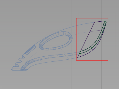

You have trimmed out a part of the vacuum design that can now be used to create the dust bag and cable connector.
The original body surfaces are unchanged, and are shown on the invisible (pale blue) layer.

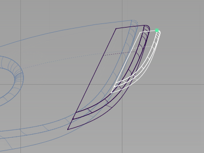

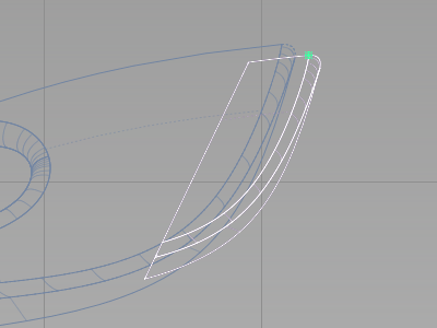

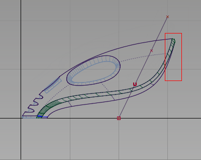

Next group the surfaces so that they can be scaled and positioned to complete the design of the dustbag.

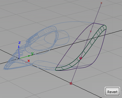

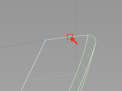

Next move the pivot point to the end of the surfaces using curve snapping. Use the pivot point to control the scaling of the surfaces.
Drag with the
to the pale blue cross at the right end of the surface to position the pivot point at the end of the surface edge.

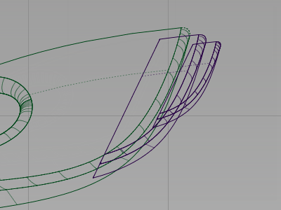

The surfaces are scaled smaller to form the dustbag.
The prompt line displays (ABS) to indicate absolute mode. In absolute mode, coordinates that are typed are measured from the origin.
Since you are moving the dustbag only slightly from its current position, switch to relative dimensioning, so the coordinate values move the surfaces relative to their current position.
You can type the x,y,z values with either a space or a comma separating the numbers.

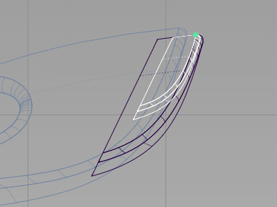

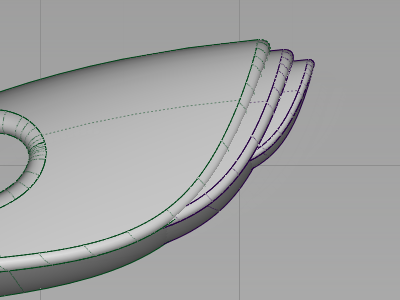

The dustbag is now in position.
The cable connector component is created in the same way.
A copy of the dustbag is created and is selected, ready to transform.
If you want to adjust the design, move the surfaces freely using the mouse buttons.
For a concept design, it is typical to make changes regularly to the model. During this phase, it is acceptable to leave the dust bag and connector surfaces overlapping with the main body shape. Leaving the surfaces overlapping allows you to quickly experiment with scaling and moving the components to explore the design.
When the design is resolved, you would trim away the parts of the surfaces that are intersecting the body, to create a continuous outer surface. This trimming is covered in Part 8, an optional extra stage in this tutorial.
