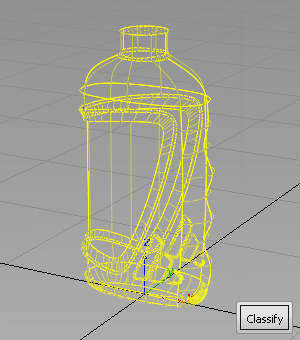

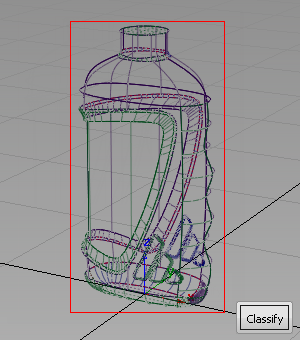

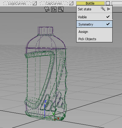

Finally, mirror all the surfaces using the Layer Symmetry tools.

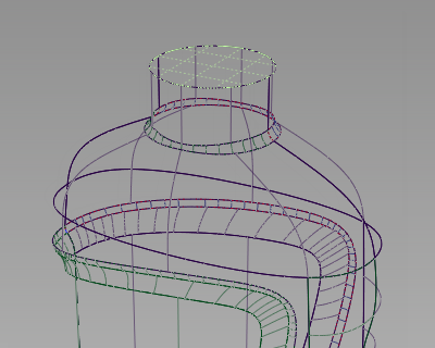

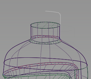

To complete the model as a closed volume, add a planar surface to the top of the neck.

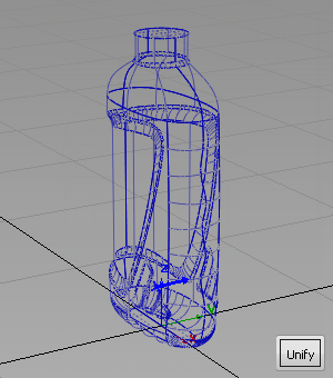

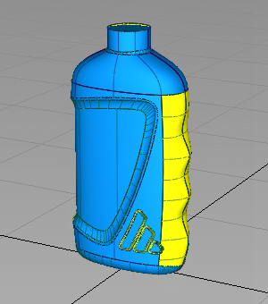

For an accurate volume calculation, you need all the surfaces to face outwards. So first unify the orientation of the surfaces.
The surfaces are highlighted in blue, and a Unify button displays.
A blue arrow also displays, indicating the orientation of the surfaces. If this arrow does not point out, away from the model, click it to switch the direction.

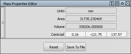

Now calculate the volume of the bottle.
The figure given in the mass properties window is in cubic millimeters. Most packaging designs are measured in milliliters.
To make the conversion, divide by 1000.
So, in this example, a volume of 338206 cubic millimeters is 338.2 milliliters.

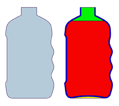

Also, the volume measured is the external volume of the whole bottle. This volume includes the liquid, the airspace at the top of the bottle and the thickness of the plastic itself. Making an allowance of 25% is a good approximation of the extra volume all these factors add to the desired product volume.
So, if our target is a product volume of 250 ml, you would expect to add 25% to account for the plastic material and airspace, giving a target of 312.5 ml for the external shape modeled. This value would display as 312500 mm3 in the Mass Properties window.

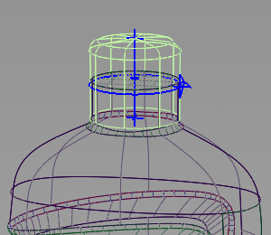

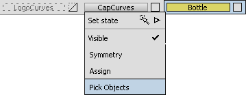

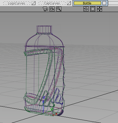

To finish the model, you can build a simple cap from curves supplied on the CapCurves layer.

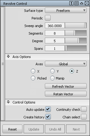

In the Axes Options section, select Global for the Axes. Global axes enable you to revolve all the curves at the same time around the origin.
Select Z for the revolution axis.
Under Control Options, turn off Continuity check.

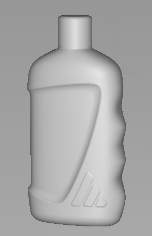

The Shower Gel pack design is now complete.
