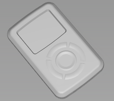

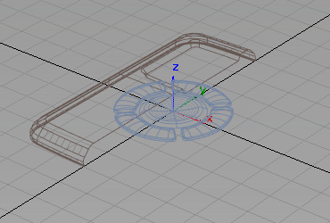

Now complete the MP3 Player design by duplicating the control buttons, and moving all the buttons into the correct position on the front casing.
If you successfully completed part 6, you can proceed directly to the next step, Create four buttons.
If you were not successful in part 6, open the file called MP3Player_Part6.wire, located in the wire folder of the CourseWare project. This file contains the completed model from part 6.

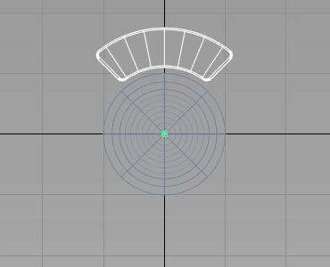

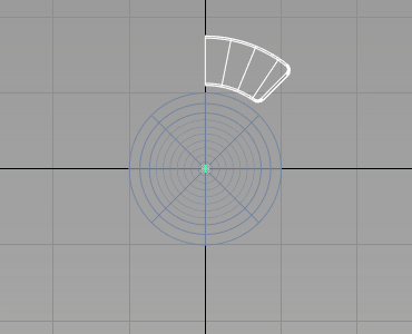

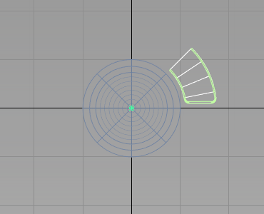

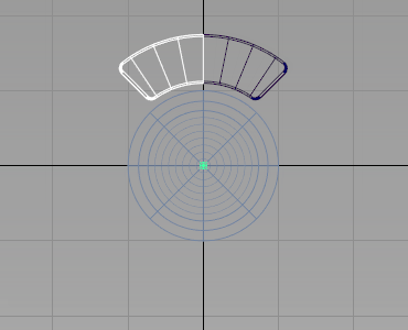

First rotate the half-button into the correct orientation, and then mirror the surfaces to create one full button.
and select the YZ plane to Mirror Across.

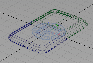

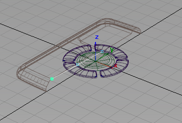

You now have one complete button, in the desired orientation, so now create three additional buttons.

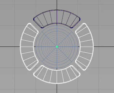

Choose Edit > Duplicate > Object
First, click the Reset button at the bottom of the option window. Resetting restores all the default settings.
Then set the Number of duplicates to 3, and the Rotation to 90 degrees in the z-axis.
Click Go to create the duplicates.
The four buttons are created.

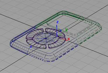

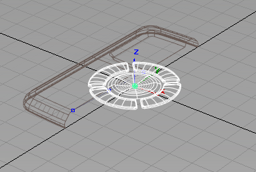

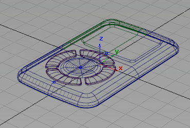

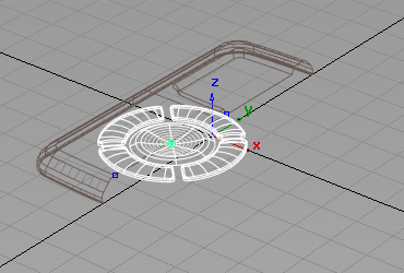

Now move the buttons into their correct location, centered on the lower part of the Front Casing.

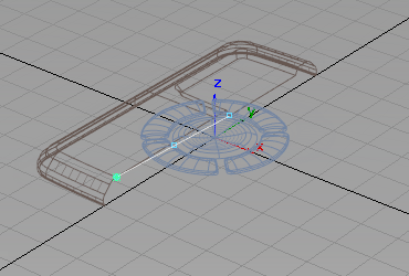

Now use the center keypoint on the new line to position the buttons.
(Windows) or

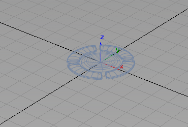

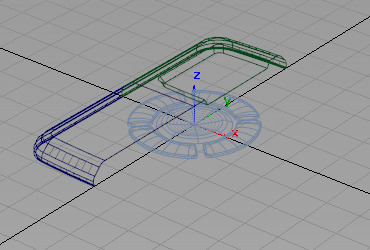

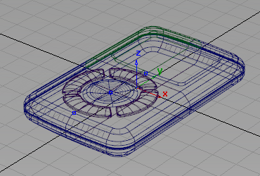

The mirrored geometry is no longer shown in dotted lines, and can be modified independently.
Save your work in the wire folder of the Lessons project. Name your file myMP3Player7.wire.
