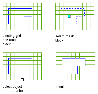

Use this procedure to mask an object by attaching the mask block to the object after you have the mask block placed correctly.
Attaching a mask block to an object
The object is now hidden by the mask block.
